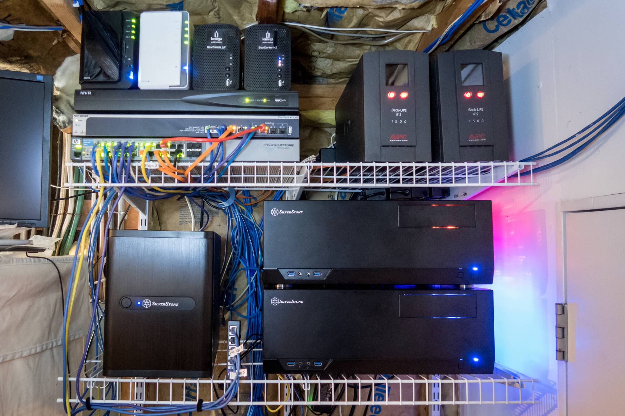

Pic of my home lab for attention.

50 feet is apparently 15 meters.
My 25 meter cat 5e link disagree cause it runs 10gbit without issues :)
That just strengthen the claim that cat 5e is underrated, but if I'd lay cables I'd get cat6-8 where price being the factor for choosing.
if cat 5e is in walls already I'd try before swapping.
