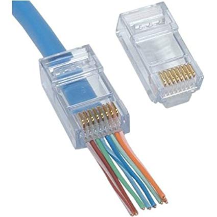

look for smart rj45 stuff.
way easier than the old way.
the tool crimps and cuts off excess.

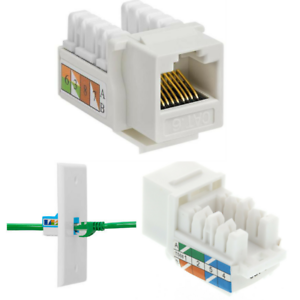

Most of the wall plate terminals are punch down with a small plastic tool like this into the wall plate terminal, these don't need a crimper and any brand is likely fine:
For the wall to switch, buy some patch cables of appropriate length, or if you just really want to make your own custom length ones any standard crimper will do. Theres not enough cables unless you got a mansion to matter IMO.
