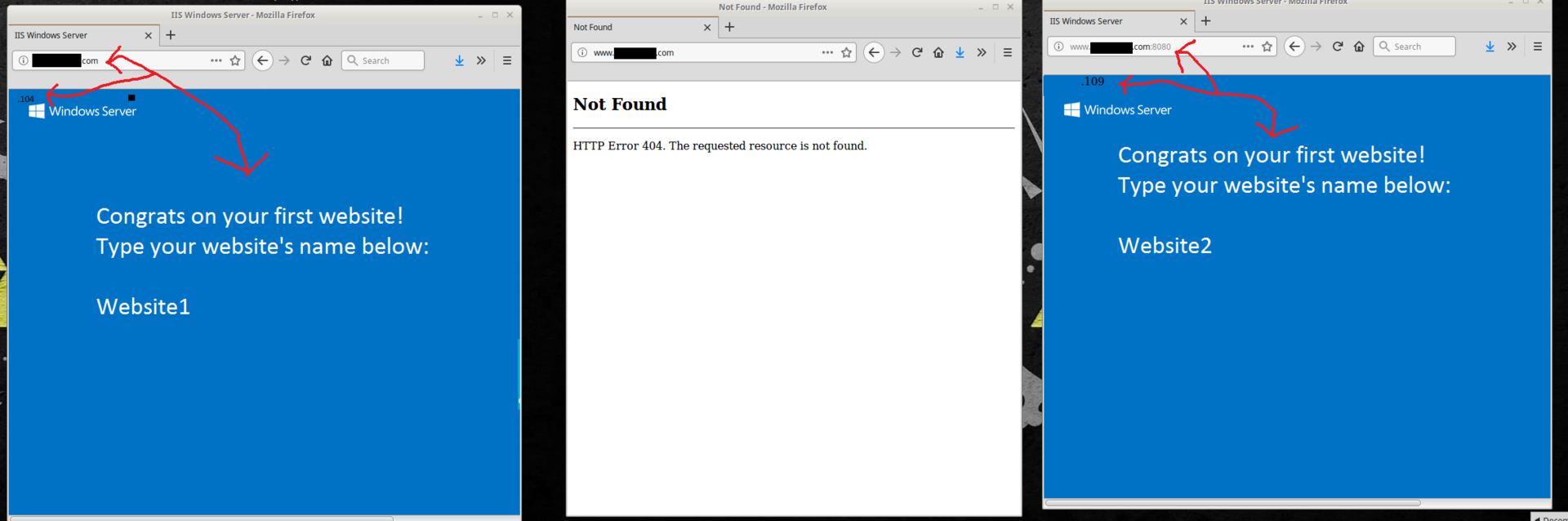

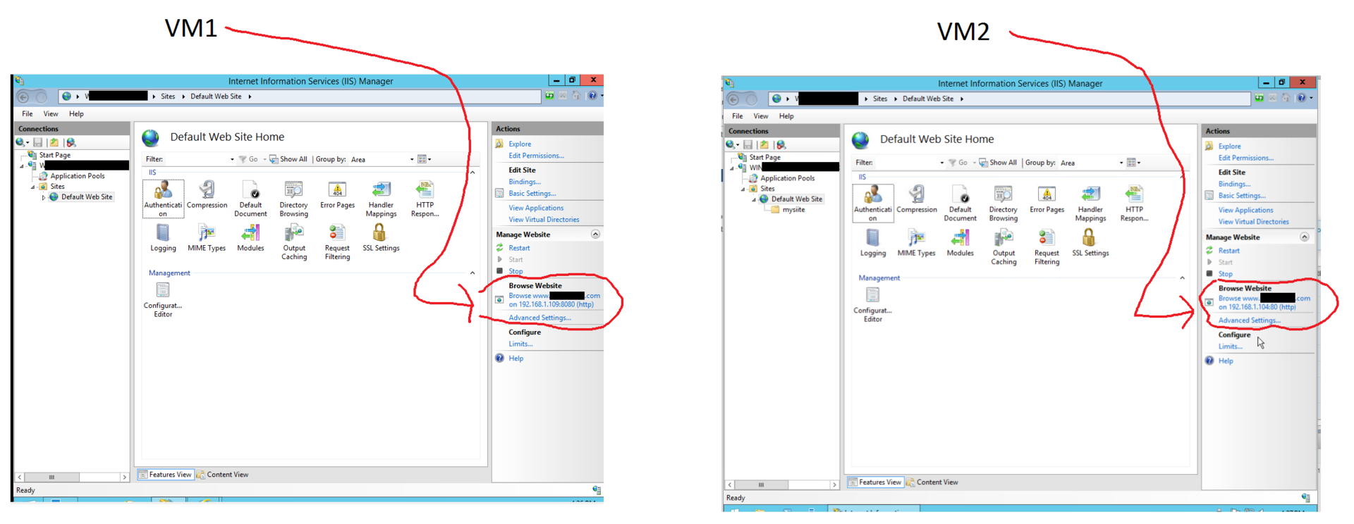

well, so far, i am having pretty much the same problem i got a little further than orcale virtualbox, but esxi still is giving me problems
i got both virtual machines web servers up and running and domains working, but
for the first domain, everything is working fine,
but for the second domain, i have to put :8080 at the end of the domain
my settings,
typing domain
i think that what Riouken was saying at the beginning of the thread, to make another virtual machine, a reverse proxy virtual machine, will solve my problem
on step closer!

You can run them both in IIS with no issues on port 80, but you have to update the bindings so each site only listens for a specific host name. Delete the default website, and create 2 new IIS sites for each web site. So you'll have site 1 listening on port 80 for 'www.website1.com', and site 2 listening on port 80 for 'www.website2.com'. Any other host names will be ignored by IIS.
If you want to keep the second site on a linux box, you can setup IIS as a reverse proxy and forward requests for that site to the linux box. No sense adding a second server to do something an existing box is already capable of.
