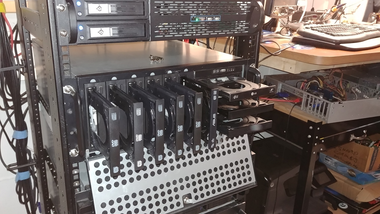

Here are a couple of pics of the new case I'm working with. Right now it has the 7 optical drives and USB2 guts from the old case in it. But soon it will hopefully be filled with 11 drives and a USB3 interface, one way or another.

Ok new situation. I use the following cables, formerly the USB2 and now the USB3, to turn this tower into a nice clean USB device. But in the past i've had to cut and drill very ugly holes into cases. Even with a Dremel, the squares you need are small enough that you're always going to end up making a mess.
My case has a bunch of what are called "SCSI" sized mounting bracket spots on the back. Are there any standard brackets made that I could buy? It would essentially be a flat piece of metal with all of the proper screw holes and port hole already cut nice and clean. Then I could just screw it in to the back fo my case (or rivet it).
This USB2 cable comes with the USB2 version of the exact style of bracket I'm looking for. Except for the taller USB3 port. And I already have the cable, I just want the bracket.
https://www.serialgear.com/serialgear_usb_serial_products.cfm?sku=USBG-2BBQ&catid=&cats=
Followup: Deep down inside, I knew I was never going to find a mounting bracket, so I figured what the F, i'll just spend the 2 hours and make my own. I had this old generic computer case in my scrap pile, that had this interesting metal piece related to the PCI slots. It was rolled over on one edge, making it much stronger than a flat piece of metal. So I went with that, got out the dremel, and carefully cut the square. Then drilled in the holes. It came out pretty well. I have a rivet gun so I used that to install it since my new holes were not threaded. Should work well for the life of this machine.
