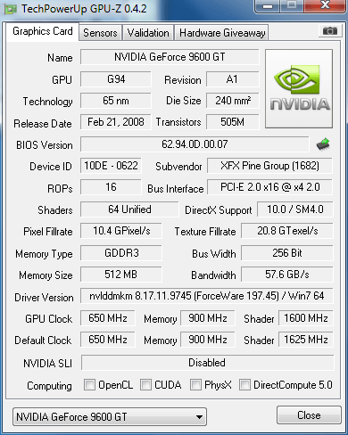

I just upgraded to a 5850 from a 9600gt a few days ago, and tonight I thought to myself... "Hmm maybe I should un-retire my 9600gt for PhysX and DC stuff"....since I have a second 16x slot (4x electrically).
Anyway, long story short, BOINC doesn't recognize my nvidia card. Apon further investigation it seems CUDA isn't enabled for some reason.
As you can see I have the latest drivers, but niether CUDA nor PhysX is enabled. I have tried the previous version of the drivers, as well as reinstalling the latest ones.
Am I missing something obvious?
TIA
humm maybe nvidia locking up the card even more now when detecting a ati card as primary ?
Well it would be the GPU manufacture's version of a three year old throwing a tantrum.
Sounds about rite for NV.
Did you recently re-install or update BOINC? If so, make sure the middle box (To run as a service) is not checked during setup. If you check that box, it will de-activate the use of CUDA in Vista/7 boxes. I'm not sure if it affects XP systems.

If PhysX was enabled and you had an 5850 installed then that would let you have a cheap gaming card installed and use PhysX AT THE SAME TIME. Oh no, we can't have that that would allow most gamers to use PhysX says Nvidia so they screw around with the drivers and make you buy a gtx 470. You have to get hacked drivers to allow PhysX with ATI hardware but I'm not sure if they also enable CUDA. Good luck.

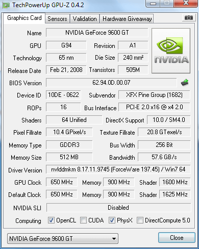

Thanks for the replies. I haven't solved it yet but I'm getting closer:
Notice now that OpenCL and PhysX are now enabled. I applied the patch/hack to allow PhysX with an ATI card found here.
Still no CUDA though...
I checked to see if BOINC was installed as a service, but it doesn't seem to be (Win7 Pro 64-bit anyway).

OK Update:
This is weird but it appears to be working. BOINC has detected the card and is crunching with it. The weird thing is that GPU-Z still doesn't show CUDA as being enabled (BOINC does though), and on the sensors tab of GPU-Z it doesn't show any GPU load, however the temperature does go up.
Very odd, but it appears to be working so I'm not too concerned.
Thanks for the help all!
OK Update:
thats because GPU-z is seeing it as the secondary card which by default in the program says cuda wont work but it does due to the hacked drivers.. woot woot..
