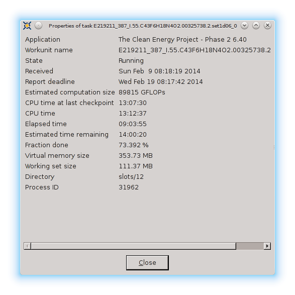

The CPU Time reported by BOINC Mgr is not the same as the Elapsed Time.
I am curious if anyone else is experiencing the same thing, or understands the cause. The only thing I can think of is that the CPU Time is based off of the benchmark values for a single core, where the Elapsed Time is the actual processing time of the WU. This wouldn't be an issue, except some projects stop after a certain number of CPU Time Hours.

Running 31 threads on 32 cores from a ramdrive (ramdrive syncs to ssd every 60 seconds)
What you are experiencing is odd. I am wondering if you had rebooted since the last check point or had shut down BOINC manager and reopened it. The Elapsed Time should always technically be greater than CPU time because CPU time is how much time the CPU has given to the work units and Elapsed time factors the Work Units and all other processes using the CPU (such as the OS)
For example, CEP2 does a ton of disk IO's. The time spent doing those don't get added to CPU time because it doesn't crunch during those. However, Elapsed time should continue to tick away...
The good news is that credit is typically calculated based on CPU time. Or at least that was the last I had heard. This issue does happen from time to time and there was a post over in Cosmology (though it should have been at Einstein) back in 2010 with someone mentioning the same issue.
Thanks for the quick reply.
boing & boincmgr haven't been restarted in the past 4 days and both WU pictured above were downloaded and started without interruption.
I am under the same understanding as yourself, that CPU time should always be LESS than elapsed time. I can only assume that it is either using more than one core, the CPU Time is based off of benchmark time or it is referencing the stock freq not overclocked freq (note turbo is disabled on this system, it is permanently running at 3.9 on all cores at all times)
Then I would suggest restarting and see if this clears up. Or wait for these work units to finish and see if it continues. Elapsed time should always be greater. On a Credit New project, you would be losing points because of it.
Elapsed time takes into account the additional overhead a work unit may have outside of the CPU as mentioned above with CEP2. Systems using Elapsed time are taking those additional over heads into account. Otherwise, those apps penalize you to run because they are "wasting" time that could be generating points.
I'll try waiting, but am not hopeful, failing that a reboot.
