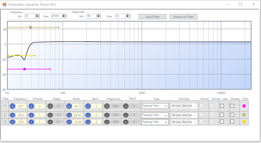

The cutoff at the subwoofer in the DSP is at 38hz coz this frequency in small rooms is useless. So I earned some gain/level. (sorry for my bad english hehe). But in the middle I need a big adjustment at the coax from 200-3000hz up to 10db. Its much. The reason why is the crossover. It fits not perfect to the speaker especially with a random housingfront. Usually, if u develop a speaker u test some crossovervariations and some housingfronts and measure and adjust the crossover and/or the housing. But in this case, the optic is more important. Even it’s a partybox and nothing for excellent sound. For this part I have my LIA AMT. Compared to what u could buy in an electronicstore, the speaker is very good (Bose/Sonos)
