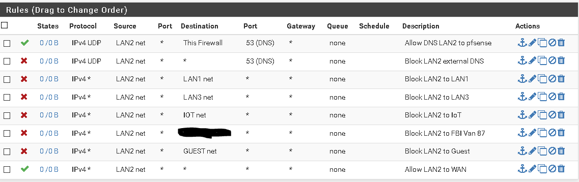

I have been tracking down some errant ADware issues on my home network and I learned that some of my devices were completely bypassing the PFSense DNS resolver. That lead me to finding this link:
https://docs.netgate.com/pfsense/en/latest/recipes/dns-over-tls.html
I am confused between redirecting DNS queries and blocking DNS queries. Both ultimately force the client to query the PfSense resolver, but what is the difference between redirecting and blocking?
While I am here, can someone explain why DNS over HTTPS cannot be blocked on the firewall? I am assuming because it uses the same port as regular traffic and its not possible to tell whats DNS versus everything else.
You need to set your rules for DNS only to your LAN and block external DNS.
The names are pretty descriptive of what's going on. One simply blocks the connection, and it fails (and the client may or may not try another resolver). The other redirects it to some other destination (e.g., your own DNS resolver).
Pretty much. Off-hand, about the only I can think of to block DoH is an application firewall that sniffed out the SNI and compared it to a list of known DoH resolvers. But that would still miss a lot and be a bitch to maintain. (And thankfully, even unencrypted SNI will not be a thing in the future.)
Use the firewall to block port 53 and 853 then do an allow rule and point it to your PFSense box, as Farva put above. This way nothing can bypass DNS, unless it starts using DNS over HTTPS, then you are screwed. Do not do a redirect if you are trying to clean our adware.

By simply blocking DNS, any systems using a DNS server that is not yours, will simply not work. You can then monitor your firewall logs for outbound requests on port 53 that are blocked and find your source

Limiting the DNS request to only be through the pfSense server and then not allow any third party or external resolution is very, very important. Honestly, every business and household should be at this level of security, and any ISP provider in which you cannot run your own endpoint is not worth it. If you ever watch your network you can see just how many devices try to talk to an external DNS's-it can be very eye opening about security for the newly initiated.
With pfBlocker you have a DNS sinkhole. Any rule that it not allowed is blocked. So, many ads, malware sites, etc will just get the packet dropped based on the feeds. However, there is an inverse relationship with security. As security increase usability will decrease. Working the feeds to be just right for usability can be a bit annoying, but you again will see how much will "call home." The caveat I do not like is how the talk on the network can increase much-much more due to blocking (sinkhole). But honestly, Do you really need all these devices?
Mix those the rules, forcing DNS to local server, NAT redirection of DNS requests to be force through the local server, and then finally sinkhole the requests can and should be practiced by all-if at all possible
To note when you have DNS redirect properly configured, in states summary you will have something akin to this LAN Address:12345 -> 127.0.0.1:53 (8.8.8.8:53). So, your Amazon Echo 192.168.0.x:12345 -> 127.0.0.1:53 (8.8.8.8):53 would get redirected to use local cache, root server lookup, or directed to the poorly secure "encrypted" server at Cloudflare...which BTW is a Google co-project.

Oh, one last thing...remember that when rejecting you allow the network to function and resolve routing issues. So, with the DNS redirection you want rejection. VLAN's , for example, you want blocking, due to the need to filter the networks and only allow particular local area network interaction. Blocking you are saying fuck you, such like pfBlocker helps with if-for instance-a malware packet tries to find its way in or out.

Keep in mind these rules are not completely blocking DNS. You can use TCP to send DNS requests, and generally speaking TCP is used when the message length is over 512 bytes.

Block port 53 from LAN clients to external recursive DNS resolvers, and also consider using a traffic-aware edge security appliance that can apply web content filtering policies externally to DNS filtering.

Thank you for taking the time to post all of this. I have read this multiple times now simply because this isnt something I am very familiar with and spent a lot of time re-reading the pfsense manual and also reading up on things.
One thing I learned and it would probably be good for others to know is, PFsense by default queries the root servers for DNS in Resolver mode. Which is good.
