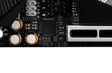

i would confirm which rev you have, get the bios, rename it, reformat your newest usb to fat32, plop the bios on it in the root and try again.
I do NOT know which version I have. I will check. Thanks for the links.
that could be all thats wrong then. the box might say on it, otherwise its down here:
As it happens, upon inspecting the motherboard I discovered I had version 1.3 and was trying to flash BIOS 1.0
