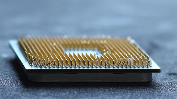

yup. its when they look like this that you got a prob

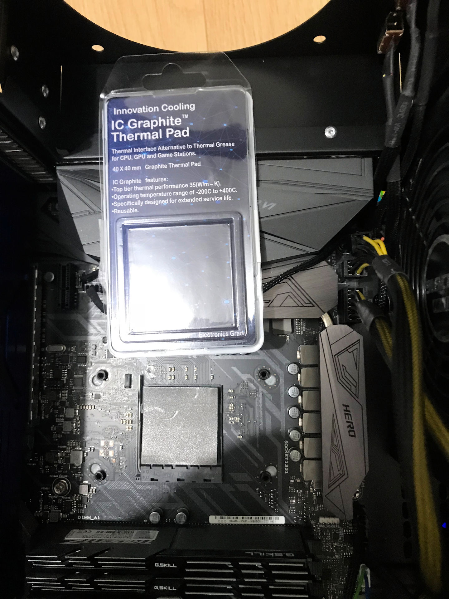

No twisting involved, no cleanup, reusable, no air bubbles:
Get the bigger size like this for Ryzen AM4, as you can see it covers the whole socket. The smaller version works great for Intel 1151 pin sockets. You may loose 1c but then again you may see a gain over a not perfect application of TIM. This is the 3rd or 4th time using or reusing thermal pad as in taking off the water block and putting it back on. 1700x -> 2700 -> 3900x. No degradation of performance when re-used.
Noko what kind of performance do you get with these? I had one in my hand at microcenter but thought maybe it was kind of gimmicky so I put it back.
I am getting great performance, clamping pressure, as in more, is the key with these pads. Linux looked at these last year if you can take his voice.
https://www.innovationcooling.com/initial-desktop-tests-ic-graphite-vs-gelid-gc-extreme/
You can get a 90x90 pad which looks like will be the size needed for TR. One very unique property is that it has excellent side to side heat transfer which will conduct heat to more of your cooler. The Pad Linus used was smaller than the heat spreader, I suspect having a bigger pad as in 40x40 the cooling will be better since the pad will conduct heat all the way to the edges transferring heat to more of the cooler/heatpipes/water. I have a 40x40 pad for the 3900x and it covers the whole heat spreader.

Buy the bigger 40x40 pad, beware these are very electrically conductive, if AM4 they will fit about perfect with a little overhang but should not pose a problem.
IMPORTANT:
  • Best if you lay the motherboard/case so the CPU is flat or horizontal - these pads are like Teflon in slipperiness and will move out of position real easy
  • Any movement of the block will most likely move the pad somewhat off the CPU - can be a real bitch
  • So beware and try it a few times down and up on the block until you are confident that you can put the block on without moving the pad and then tighten down the hold down screws
  • Clamp/Clamp/Clamp obviously not so tight to break anything, use washers if needed for more clamping - I didn't have to do that
  • The second link on the above post, the guy used thermal paste on the corners to keep the pad stationary - I didn't do that and advise against that unless for some reason you find you cannot keep the pad centered on the CPU while putting on the block - if it is offset it will suck and you will know it (I did)
  • The pad can be used over and over again without any degradation of performance (unless it gets contaminated with paste or damaged)
