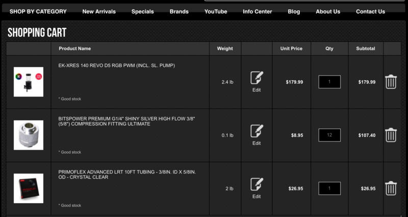

So I am looking at this...
To go with...
I always value your opinion. Have you worked with Mayhems also? What difference have you see? I see you linked 3/8-1/2. Is that your favored size? I am not sure the advantages/disadvantages of a thicker/thinner sidewall.
I have not used Mayhems. 3/8x1/2 is the standard size we use on our test bench here. I have been replacing all our old tubing when it comes time with PrimoFlex. All the block pigtails I use here are PrimoFlex now and have been for about a year. I has had great results.
