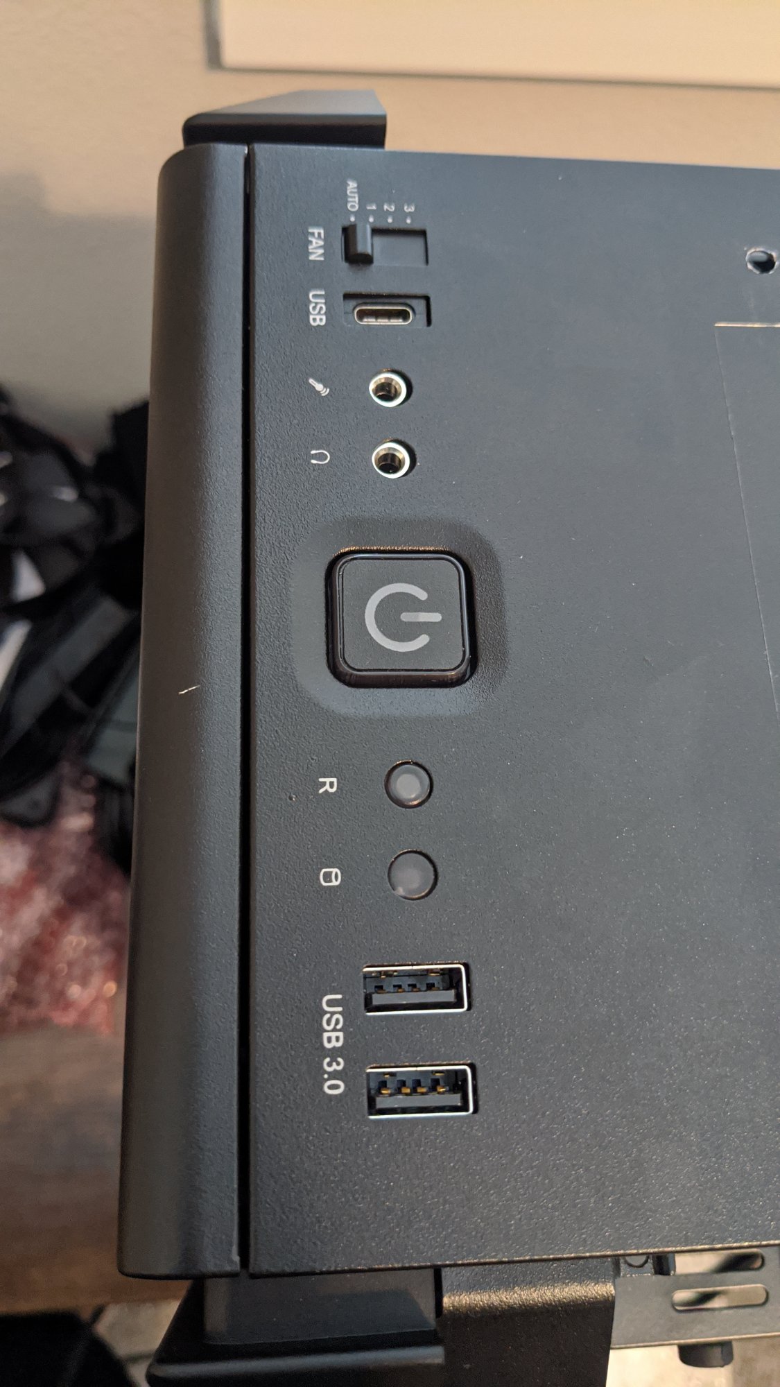

  • Switched out fan controller to Dark Base pwm controller with LED headers
  • Switched IO panel to Dark Base unit which includes USB C and the correct header to operate the pwm fan controller

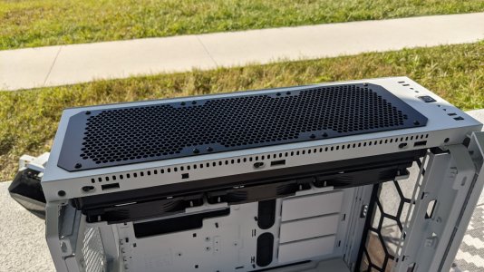

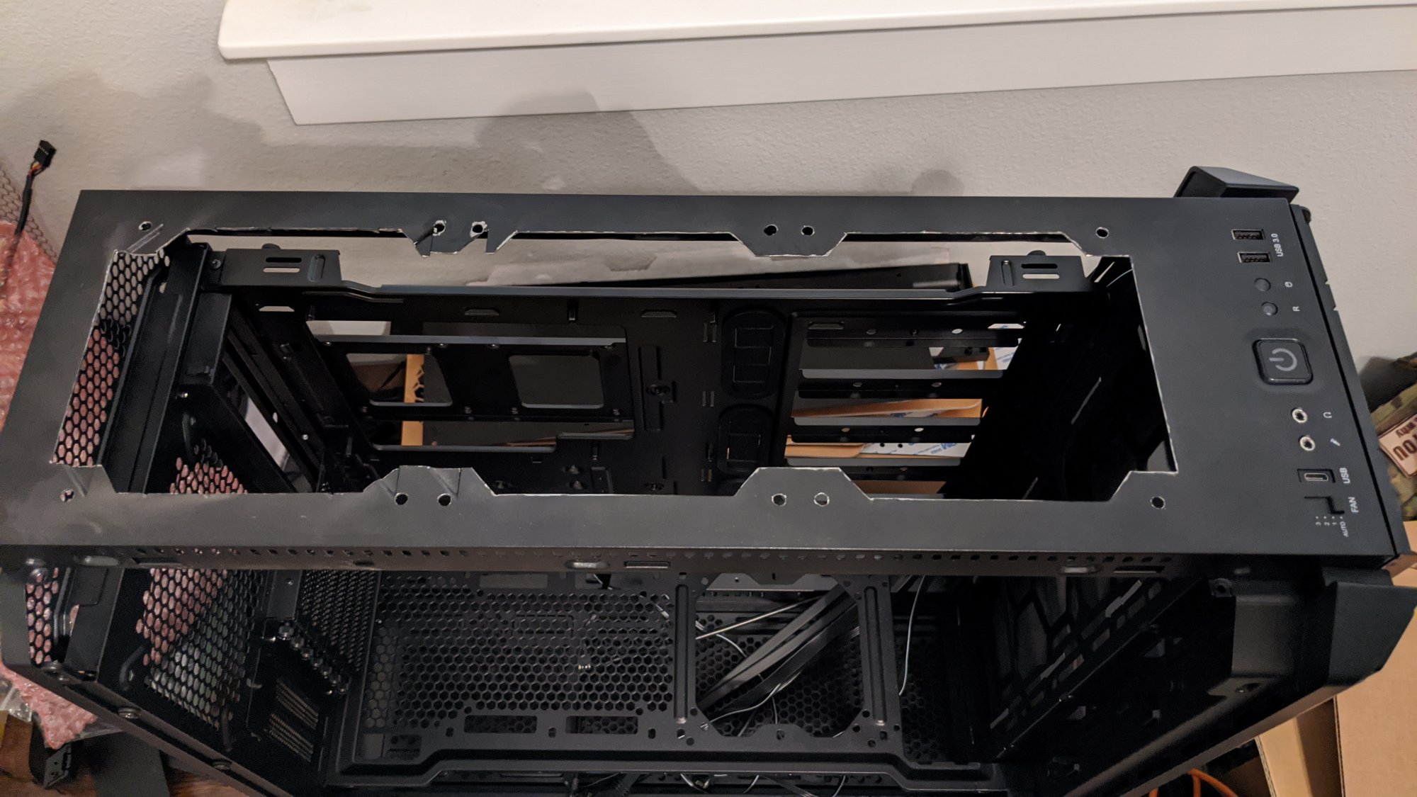

  • Cut vent in top panel for Nemesis NLX420 radiator.

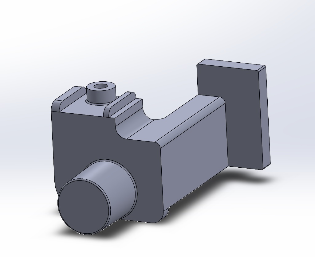

  • Custom Button 3D printed for side panel release mechanism

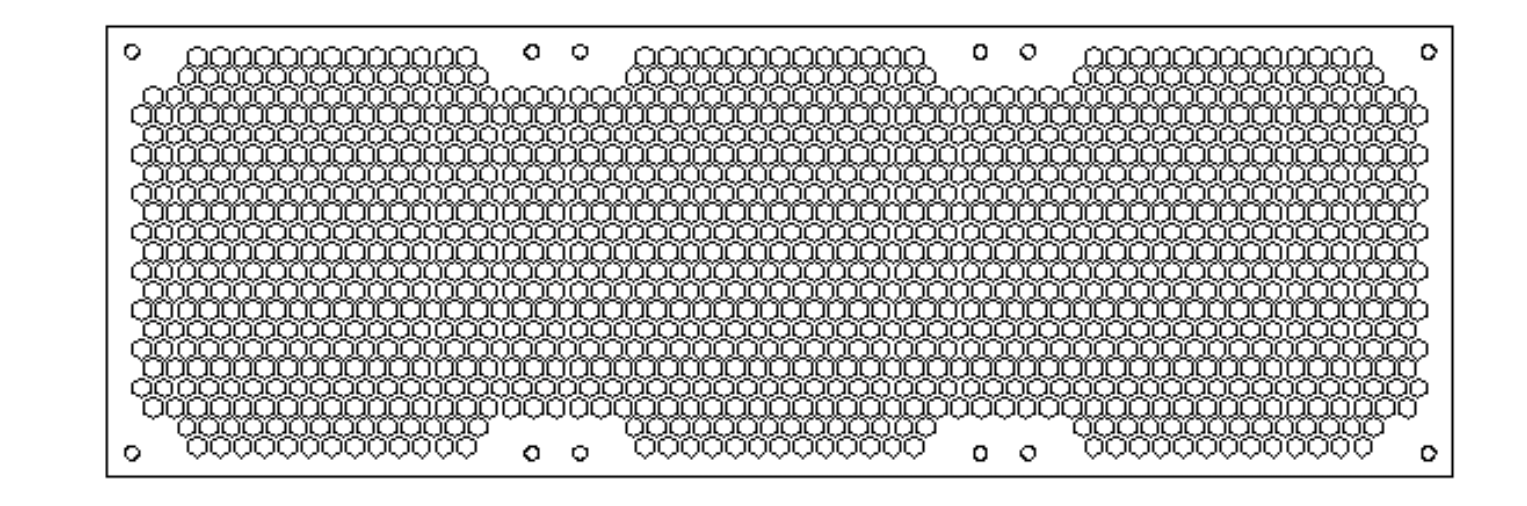

  • Designed custom grill for top panel, laser cut.

Custom button for release mechanism sent off to shapeways. This button was needed to clear the radiator...Maybe should have gone with a 360 instead of trying to stuff a 420 in there, lol.

Custom grill mocked up. Fits well, but there is a little warping causing some gaps in-between the screws, will need to tack weld or epoxy I think.
Cut out 120mm mounting at front to increase 140mm air flow.
So work continues, priming, painting, clear coat, very tedious. About 75% complete, then see news that BeQuiet is releasing the Silent Base 802 in white which is exactly what I've been building. Awesome...
So I'm changing the name of this build from the Be Quiet Air Flow edition to the Incredible Value for Your Money build... Since I decided to go with the best value items like two Be Quiet cases, 3090 FTW ultra, 5800X, Asus Dark Hero... Got the Silent Base 802 modified to fit the 420 radiator and got the power supply and a few place holder fans installed. Still waiting on motherboard and some water blocks to come back in stock. Pretty happy with how it turned out. 3D printed buttons work as intended and didn't run into any big issues. Surprising for 2020.

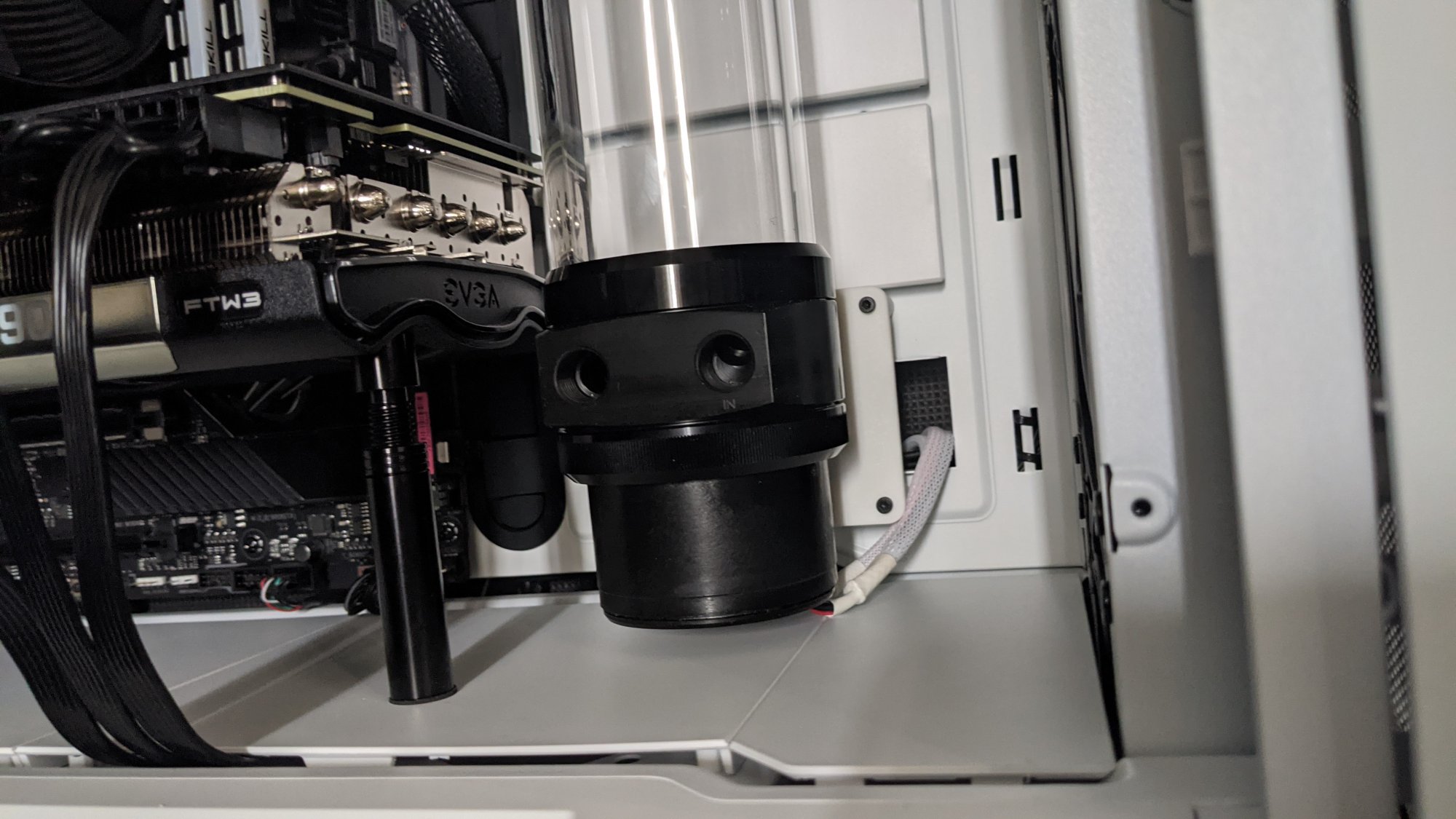

Custom mount for reservoir sent off to shapeways. This will hopefully give the reservoir/pump combo the illusion that it is floating a little bit. Thats the idea anyways.
MB finally came in so I was able to build! Went together without any serious issues. Glad I waited till 2021, for sure would have had issues last year. Not super happy with the Octo fan controller. Since it uses molex the power connector sticks out about an inch. So instead of a clean mount on a SSD tray on the back I had to double stick tape it up top on the radiator. Lame. System runs great, 6069 mc and 630 sc on cinebench r20. And holy shit games.... This is what y'all been talking about. Went from 2700k and 970gtx to 5800x with 3090 with gsync. Unbelievable, so smooth. Now just waiting on water cooling stuff to come in stock.
Custom reservoir mount test fit. Looks good, just need optimus to bring the gpu block back in stock and we can move forward.
Reservoir test fit because I'm bored waiting for Optimus PC to get blocks in. I will clean up wiring and reinstall the cover plate behind the mount during final installation.

Posting an update on this build. It's finally done. After several years of sitting on parts I worked up the courage to take a stab at it. I have to say I have incredible respect for any one who has gone the hard tubing route. This was WAY harder than I thought. But I'm glad to say it's finally done. No leaks so far, did some light gaming after setting up additional Aquasuite stuff. I'm not super stoked about the tubing routing as I had to get weird with it at the radiator, but it'll do. It's just not as clean at most installs I see on here.
The 3090 didn't get over 52C core/72C hot spot, so I'm happy with that. I upgraded to a 5800X3D and it idles around 38C with a 31C water temp, so also good. CPU seems to run a little hotter under load though. Saw 80C gaming while on my Dark Rock 4 Air cooler it would stay mid 70s tops. Need to investigate more on that, I sure hope I don't have to drain and repaste.
Also if anyone has suggestions for a better way to route or a different set of power cables for the GPU I would appreciate it. The flow meter is pretty much obstructed the way it sits now, but it was the only place I really wanted to put it. I know about cablemod cables, but I think theirs may be too thick unless I go up with the cable and through one of the HDD covers.
