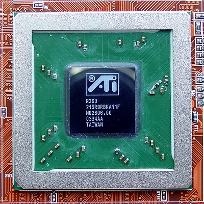

Here is a pic of the R360 core on your card after a google search.
http://image2.beareyes.com.cn/2/lib/200311/03/271/DSC04406.JPG
The rectangular metal rim on the outside of the core is the shim that helps even pressure on the core. Only thing is that the shim is something like .6mm higher than the core so the stock cooler and the Silencer 3 that you ordered have an area that is lower and fits inside the shim. I definately wouldnt try to take the shim off though as you would have to take a razor blade and cut the glue between it and the gpu, potentially, and easily, damaging the gpu in the proccess.
if the shim has already been removed, will I still be able to use my artic silencer 3?
