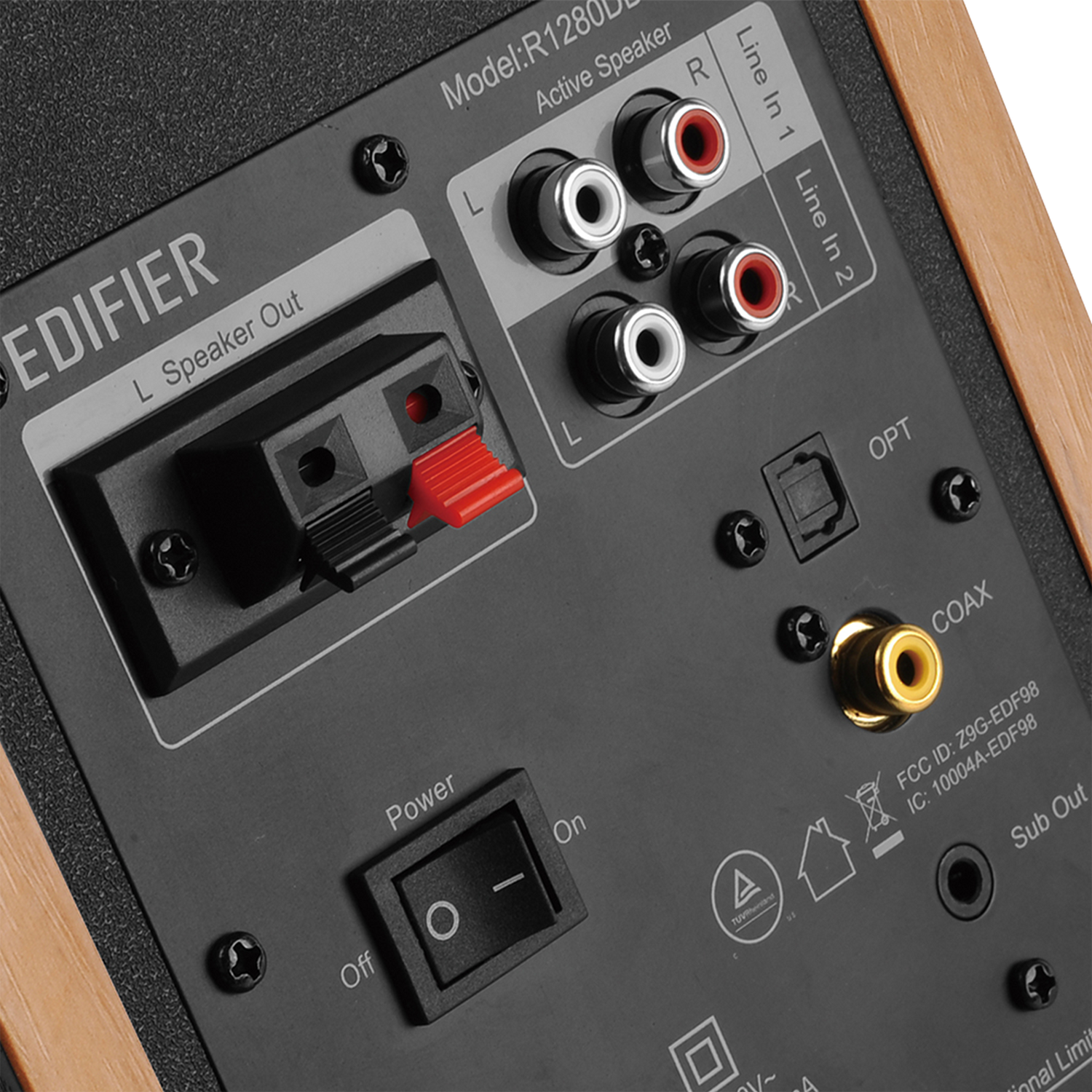

I would try the DAC that come with your speaker first, they seem to have digital inputs available ?
That mean they have everything to go from digital to analogue (DAC) inside them, you can plug your tv optical output to your speaker optical in, set the tv output to be 2.0/2.1 (optical out is purely a one direction signal with zero feedback to it), choose when available in your streaming content the provided 2/2.1 audio channel, if they are only 5.1 or above let the tv do the downsampling.
Not saying it is impossible for your motherboard onboard audio to be a better downsampler but it must be minimal if anything (and in exchange here you remove all noise from the computer and cable), it is at least "free" and really easy to try if you like the DAC in your speaker

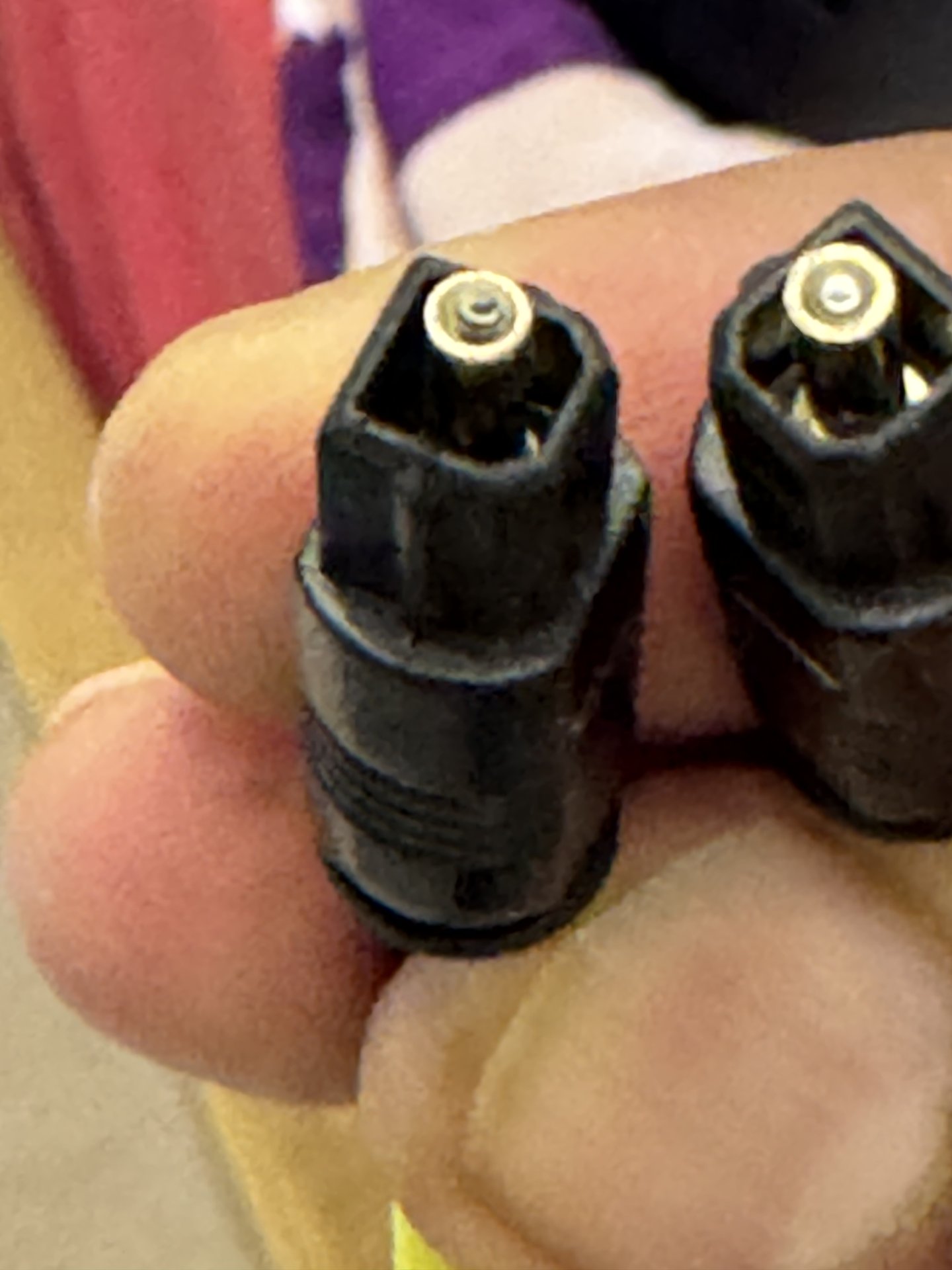

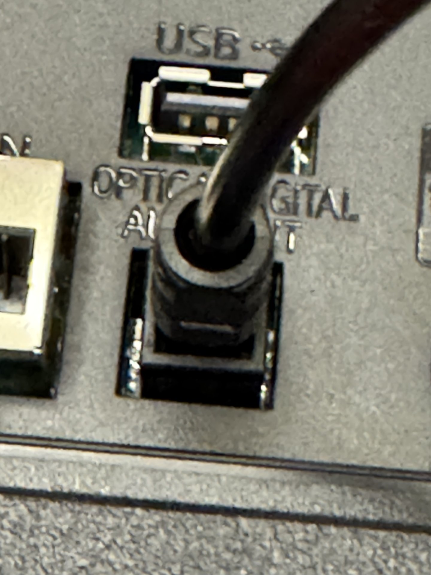

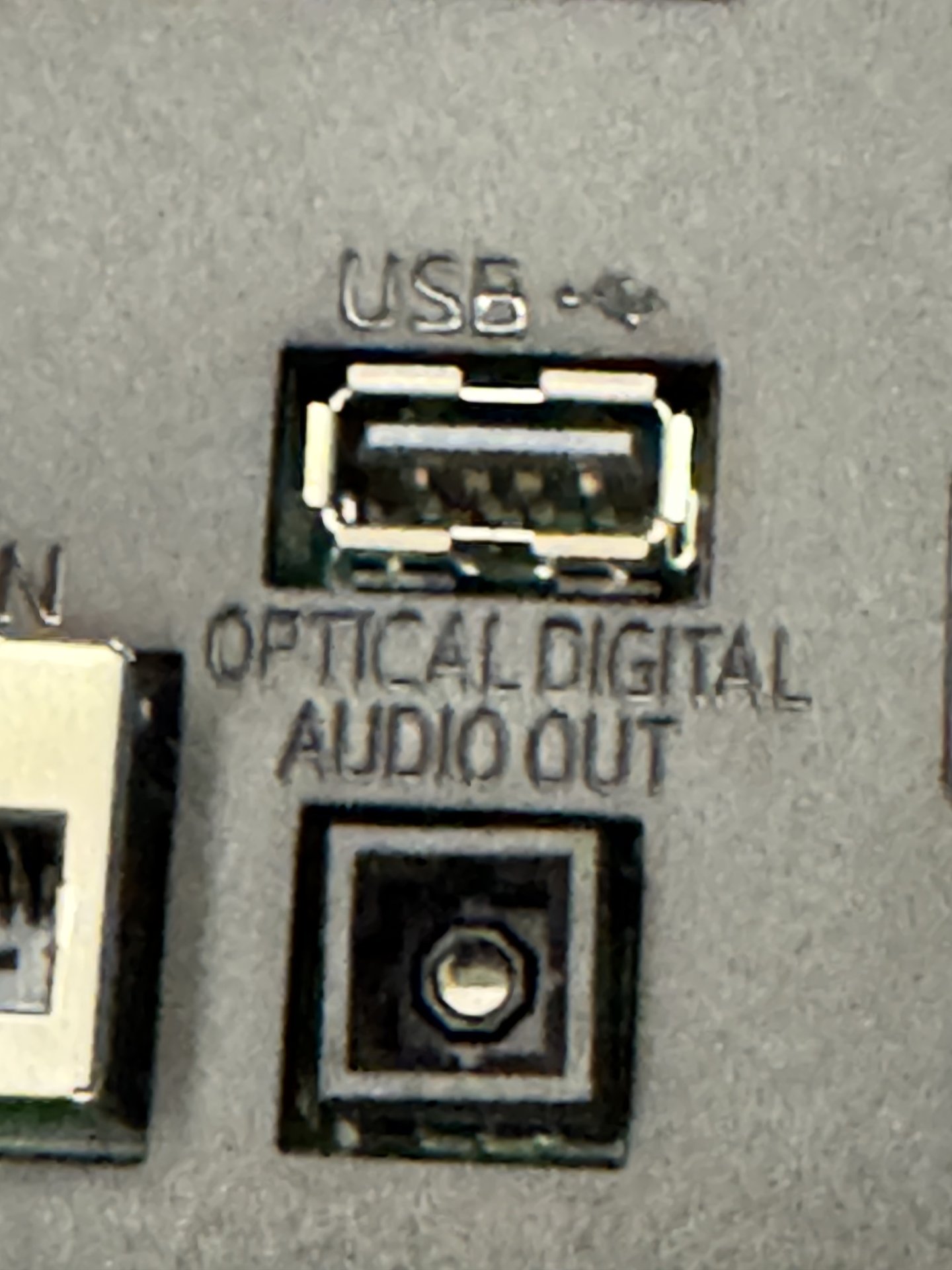

IIRC it's also not quite square. 2 corners are shaved off so it only goes in one way.
I've seen round ones before but all the modern ones I've seen are as you describe afaik. They fit fine, if it was mine I'd try some sandpaper or a wire wheel or something.
