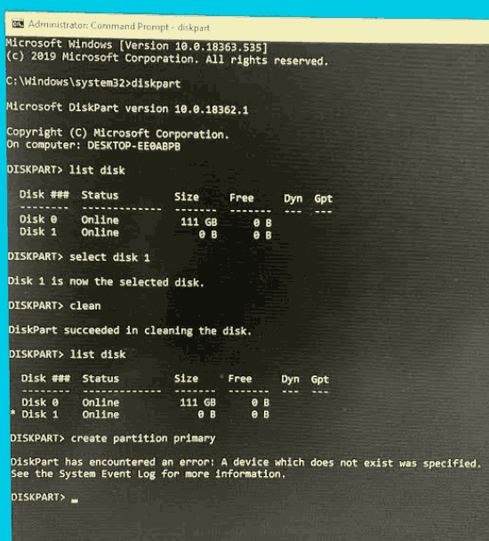

Hi, i have sold the working HDD and the buyer says the drive is unstable making non standard sounds, once he was able to see the drive and begin formating, which not completed due to "Windows was unable to complete the format". Drive sometimes not appeared in "This computer", showing as unknown and uninitialized in Drive manager and unable to initialize due to not exist (the error is non english language WIndows). The Minitool partition manager shown "Bad drive".
I advised to remove some drives / use verified working power and data cable to ensure drive has enough power supply and working cable.
Then i advised diskpart (open administrator cmd prompt and type diskpart), cleaning the disk, here is the resulting error:
"a device which does not exist was specified" 0 B disk

Maybe start with CrystalDiskInfo. If it says any status other than "Good" its almost certainly a bad drive.

This could mean the drive was damaged in shipping.
I think that the drive was protected by antistatic bag and multiple layers of the bubble clingfilm so even if dropped , it should be OK.
I hope someone can share some steps to do after which we can be pretty much sure it really is damaged and should be trashed/refurbrished.
I think drescherjm is right. The drive may have gotten damaged in shipping. You will have to use a utility to identify the bad sectors and mark them as such which would keep the data stored on it from using it.
if its been seen as 0MB sure seems like a failed drive (any clicking noises would say drive was damaged in transit)
is it a seagate drive ?
Is the drive one of the 8-14TB WD Easystore/Elements/My Books externals that was removed from the case and installed in the PC.
If it is, it would need to have the 3.3v Pin 3 mod done it it.
