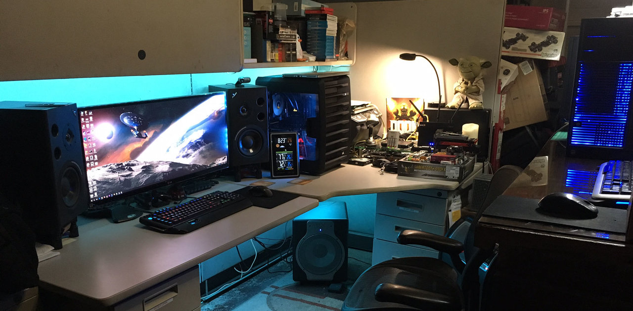

I went the slightly more expensive (because i didn't know any better) Sylvania route on Amazon. I'm happy with it so I guess that's all that matters. I got one of these starter kits:
https://www.amazon.com/gp/product/B008COVFUA/ref=oh_aui_detailpage_o03_s01?ie=UTF8&psc=1
Then two of these packs to finish the desk and tap into to do behind my monitor:
https://www.amazon.com/gp/product/B00932TERQ/ref=oh_aui_detailpage_o03_s01?ie=UTF8&psc=1
Here is an album: http://imgur.com/a/553Ki
Once it gets dark I can take better pictures from the front but right now, the window behind my desk washes everything out.

Nice! :)
Awesome, I've been wanting to do the same with my Ikea Jerker, just not sure how it will come off looking. One way to find out! :D
Great set up and suggestions.
