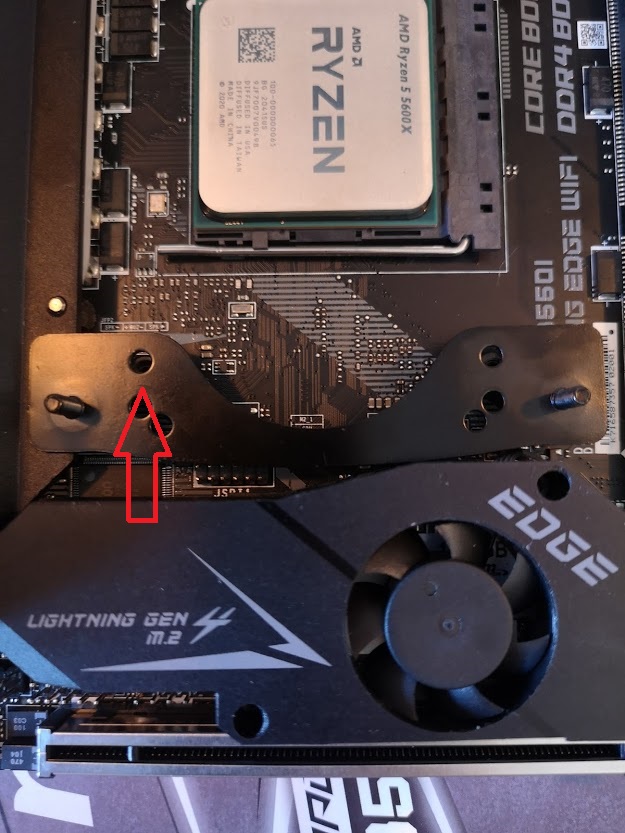

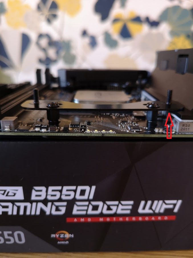

I can confirm the issue with a MSI B550I Gaming Edge.
I just got a Rev3 from Amazon.de and it doesn't fit on my motherboard.
As mentioned by Needle, rev3 mounting points could interfer with your M2 port and some capacitor cover on the left of the processor.
As you can see in the first picture, M2 interference won't allow you to screw the mounting clips on the standoffs as it's not aligned.
On the other hand, there's a clear interference with the capacitor cover around the processor....
I don't konw why Artic decided to not supply the rev2 AM4 screws which would solve this problem on some B550 mobo.... :(
View attachment 308647 View attachment 308648
This is beyond annoying. Has anyone found a solution? Is there any B500 motherboard that actually can handle this?

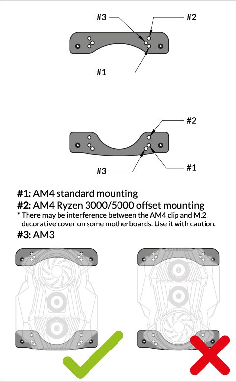

I think you have it backwards and the wrong mounting holes possibly? It should arc inwards per the instructions pic in the above:
Edit I looked at arctics website you also might have been sent the wrong screws:
Wow. I was doing this late at night, but wow. I literally was watching a YouTube video on how to install while installing and I still did it backwards. Thanks for pointing that out :D. I'm still waiting for my RAM to come in so I disassembled everything after taking my video; will try the opposite orientation today. I saw the warning about the screws as well and I thought maybe that's why I couldn't seem to screw them in all the way, because that issue I don't think will be fixed by switching the bracket orientation. But sheesh, thanks for pointing that out!

Re: wrong screws, yup I just installed one recently and the those are definitely the wrong screws included. The ones you need to use are the little bitty ones you use to screw an ssd into a drive tray, then the brackets will be nice and snug.

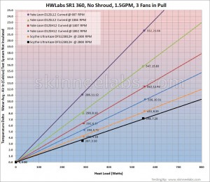

But whatever, here's some water delta information showing the difference in water temps https://www.overclockers.com/guide-deltat-water-cooling/
Physics and thermal transfer, water can't take away heat if the water temp is higher than the CPU temps which can often go into the 70-80c range (or higher).
CPU cores temps are reported by the motherboard in basically every MOBO today, based off the chart its a very limited increase in water temp considering most CPUs are about a 65-95w TDP (with some going to the 180w/240w range for threadripper and other high core cpu).
While I concede the chart is not for a CLC its a good baseline for expected difference in temperature based off heat-load in a water loop configuration.
