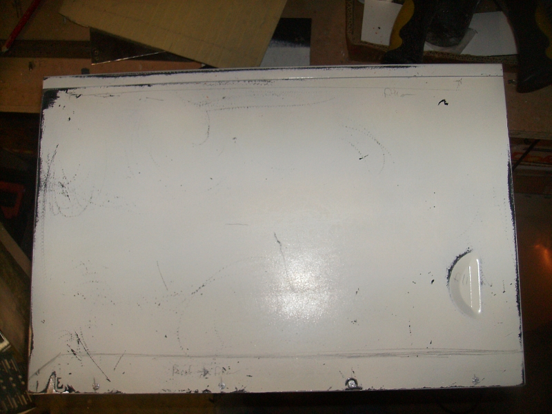

After the previous shots got out, Aperture Science Health staff came to visit - and confiscated the case! They said something about the bucket of drill bits being able to cause an outbreak of tetanus or the like. Long story short - have to start again. I have a chassis from Coolermaster (the Elite 330 All-Black Edition) that I will sacrifice to the cause to ensure this hardware has a home!
(OOC: Yeah I lost some of the chassis parts I had saved for this design... thus I have to start again :'( )

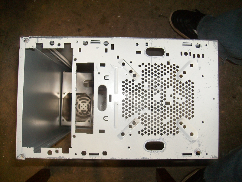

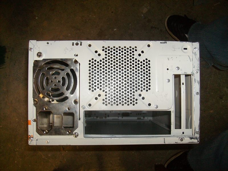

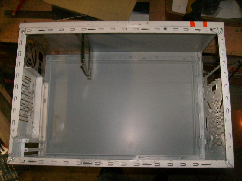

Well, after being tested, retested and probed a few too many times by the Aperture Science Health team, I'm back into building this system. As I said in my previous transmission, I have re-started the build using a CLEAN Coolermaster Elite 330 All Black edition. The chassis I came across had obviously been modified by a previous Aperture Science employee, but that's not an issue.
Some hacking, chopping, swearing, and rivets later, I'm here:
To make this look a little nicer I plan on filing, filling, sanding, and so forth to smooth the exterior out. The motherboard tray is the next major project, and with the board's unique mounting hole location, this could be interesting.
