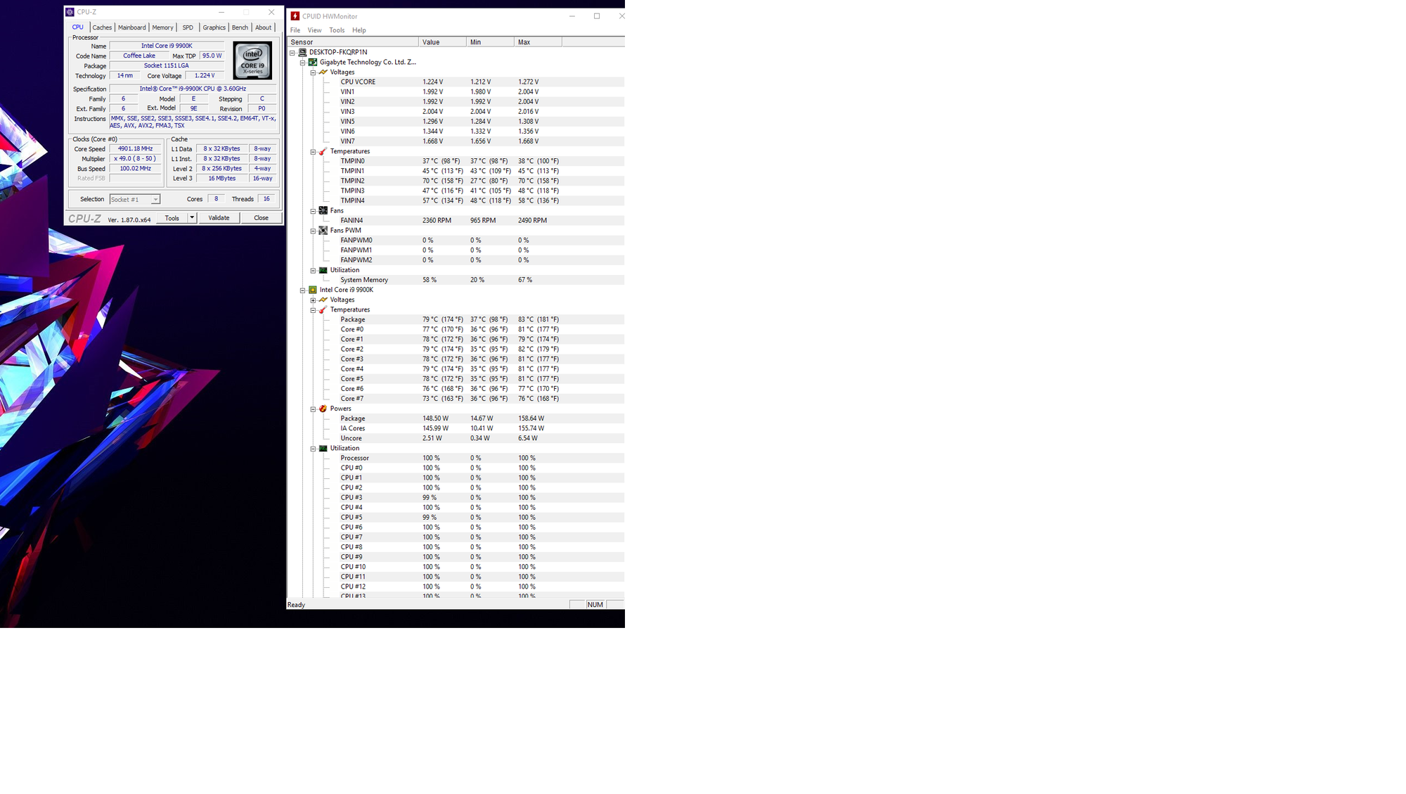

And I am back for one last question hopefully as I did not want to start another threat.
So did Real Bench for a hour and those are the best results I could achieve.Once I try to go to to 5ghz its demand for voltage doubles so does the temps.And I have spent way too much time I planed to get as far as I have now.
Is these results good enough for long term use and wont 83c temp spikes shorten my CPU life?i am using LCC @ medium .
Sounding a bit paranoid but overclocking this is way more complicated than it was with i7 6700k and the temps on i7 6700k never reached over 70c.
in Short searching for some validation.

That is a very nice overclock to be honest, and the heat is not an issue. 1.225v for 4.9 is good. Some people, like me, need 1.37v to attempt or stabilize 5.0g. Which is simply out of the thermal envelope of many processors.
I need 1.33v to hit 4.9g avx stable. Temperatures hit 96 in real bench. I simply cannot hit 5.0g stable.

Your temps are fine. Real Bench has some AVX so it will create higher spikes than you will see on regular gaming and apps unless you use apps that use AVX.
