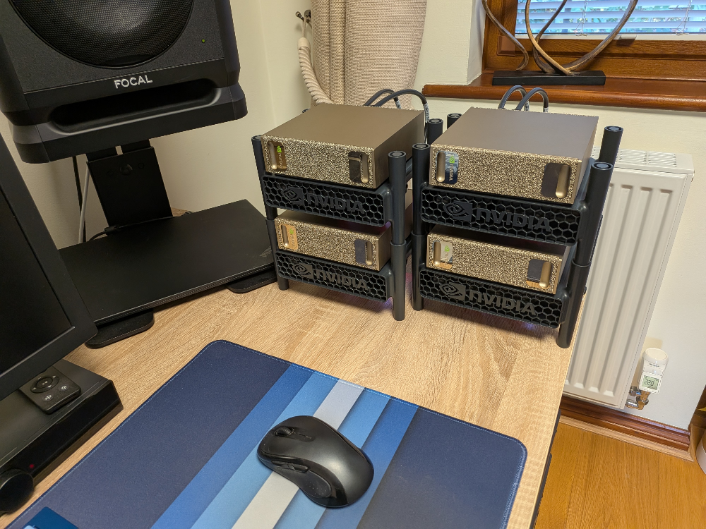

As of today this is my desktop at home:

And as a result I now had two 2-node clusters, both running DeepSeek v4 Flash 0731:
The Sparks have 2x 200G ConnectX-7 interfaces, however the NIC itself is limited to two sets of PCIe 5.0 x4 lanes for a total of 256G of bandwidth. As a result you can either run a single 100G, single 200G, or in my case 2x 100G.
The reason for 2x 100G instead 1x 200G was simply because of the switch availability. The MikroTik CRS804 can do 8x 200G with the correct and very expensive breakout cables. The other option was the MikroTik CRS504 with 4x 100G and the added bonus of having some great power input options, including PoE++.

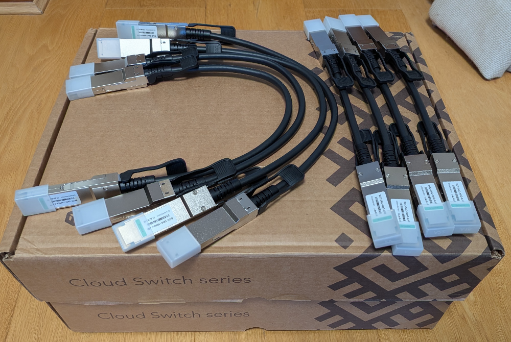

First some more deliveries:

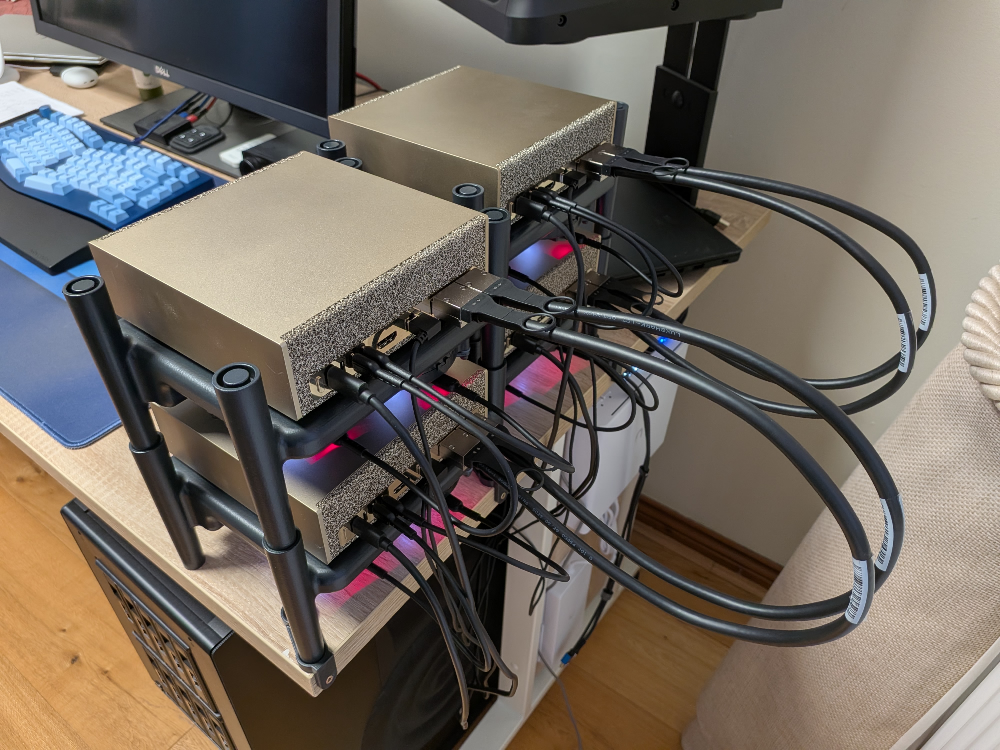

And as of now this is the cable side of the cluster:
First model loaded was DeepSeek v4.1 Flash served by SGLang.
This is a model that is utterly brilliant to work with, it is smart (550B parameters), it is fast 4-5k pre-fill and 75-120 tok/s decode with a single stream. KV cache can fit 6.66 full 1M contexts.

The fans finally arrived in September as did two more printed stands and fan control holders:
The fan controllers are from https://github.com/SasaKaranovic/OpenFan-Micro and they let me control each fan over WiFi and a simple API.
