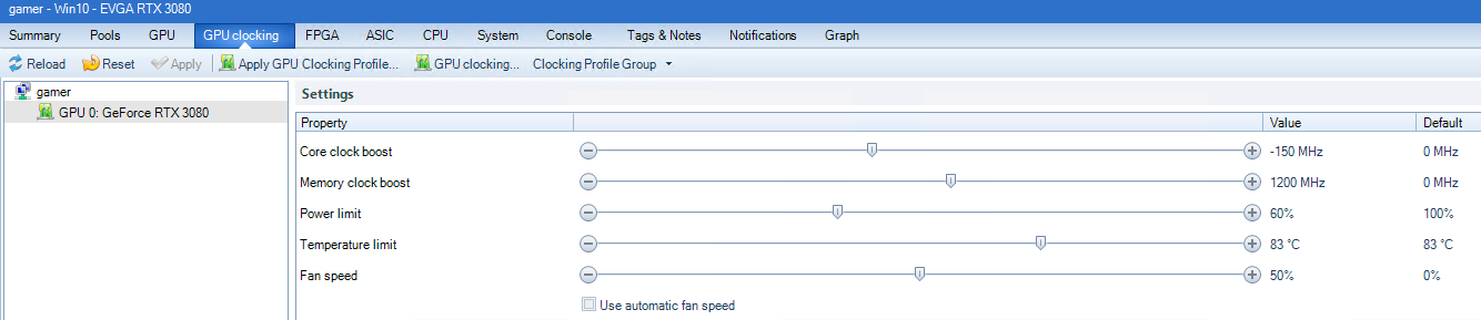

On my EVGA FTW3 Ultra, I'm able to boost that by 1200 MHz and be stable:
Which in theory would be 19000 + 1200 = 20200 MHz. In Windows, this is reported as half that, so 10100 MHz. In real-life, it seems to boost a little higher than that. In my case, to 10451 MHz:
That's my theory anyways.
The RTX 3080 has a memory clock of 19000 MHz.
With Windows and not changing the default P2 State on Cuda setting, this is how your card ends up at 10451:
Default: 9500
P2 State on Cuda application, downclocks by 250: 9250
Overclock: 9250+1200 = 10450 (rounded to 10451 probably due to the clock generator increments)
