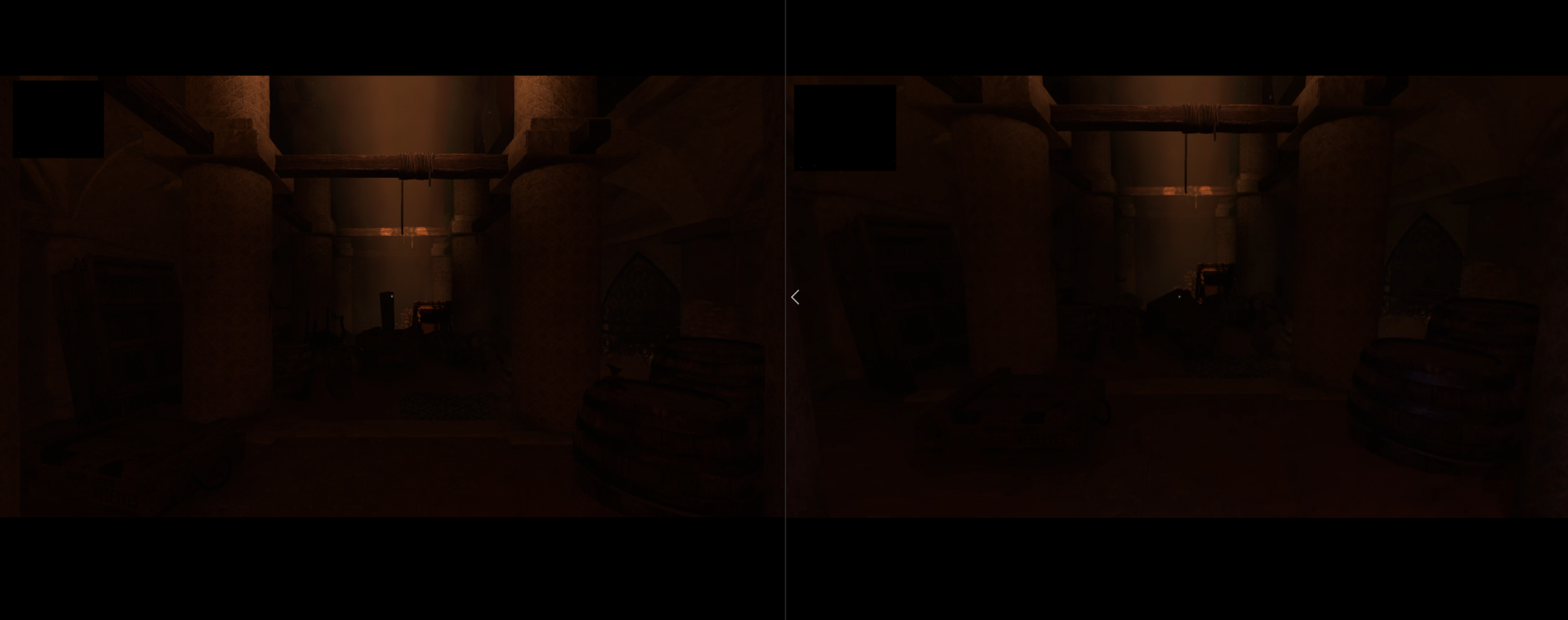

I've been using the Nvenc encoder for a while now and it's been pretty decent, but with the launch of the new Navi 2 cards, I'm interested in switching over but wanted to test the AMD encoder out first. With my Nvidia card, I've been using the following settings to record gameplay; Nvenc h.264, 1440p canvas and output, @60fps, CQP 15, and Maximum Quality. Usually for a 30-40min capture it dumps out a roughly 10GB file, recorded in MKV which I then run through Handbrake on almost placebo quality to get a MP4 which I then edit in Resolve 16 (free). I recently tried bypassing handbrake and just recording straight to MP4, but a 50min capture was 40GB. Not that I have an issue with the file size but that's quite a lot bigger.
Anyways... to test the AMD encoder, I tossed a 5700xt into my rig, and used the exact same settings, except obviously choosing the AMD h.265 encoder (as I hear AMD's h.264 is bad) and I also recorded in 1440p, 60fps, and CQP set to 15. The results I'm getting are not good... and I'm looking to find out if there is anything I can do. The primary issue I'm finding is that recording with Nvenc, Nvidia seems to retain much, MUCH more retail, and this is especially apparent in dark corner areas. With the AMD encoder, it seems to give extreme color banding? (if that's what it's called), in the darker areas. In outside enviroments, the detail seems almost the same, but since I've been playing the new Amnesia Rebirth game, I've been noticing the quality loss in dark area's when using AMD's h.265 encoder.
Also, fwiw, I did try recording using h.264 off the CPU, but even with faster preset in OBS, it's laggy as hell. Anything less, like fast, or medium will make things a power point presentation in the video playback.
So, here is a comparison shot between a dark area in Amnesia Rebirth, the leftside is Nvidia, and the rightside AMD. I know a picture doesn't do things justice but you can still see how Nvidia retains a lot more detail in dark area's. This isn't to say Nvidia's Nvenc is fault free, because I still notice color banding, but it seems to be far, far less, and the picture seems sharper with more detail. If you look at the floor you can see how Nvidia seems to retain detail where with the AMD recording it's really bad, and I'm hoping there are settings or things I can try to improve it to match Nvidia's nvenc.

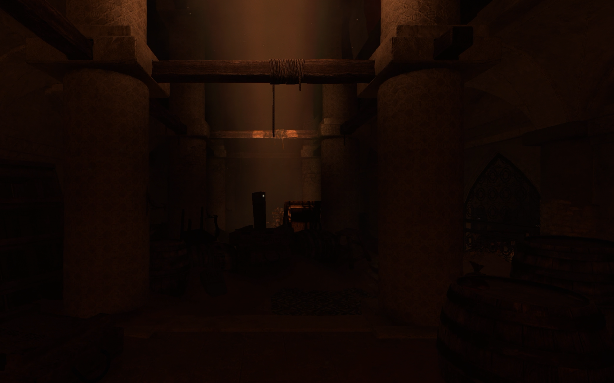

And here's a 2nd shot of just AMD. You can see on the floor, close the barricaded furniture those dark areas look bad.
OBS support for AMD is rudimentary and they haven't even had a staff member for AMD stuff for a couple of months now. I would recommend trying another software to see if the H.265 quality is better. Such as AMD's own capture feature built into their driver. or Bandicam. Bandicam is payed, but its quite good for recording. AMD's H.265 is supposed to be solid.
There is no indication yet about the encoding quality of the new Navi cards

Can you post a full sized image from both encoders so they can be directly compared?
