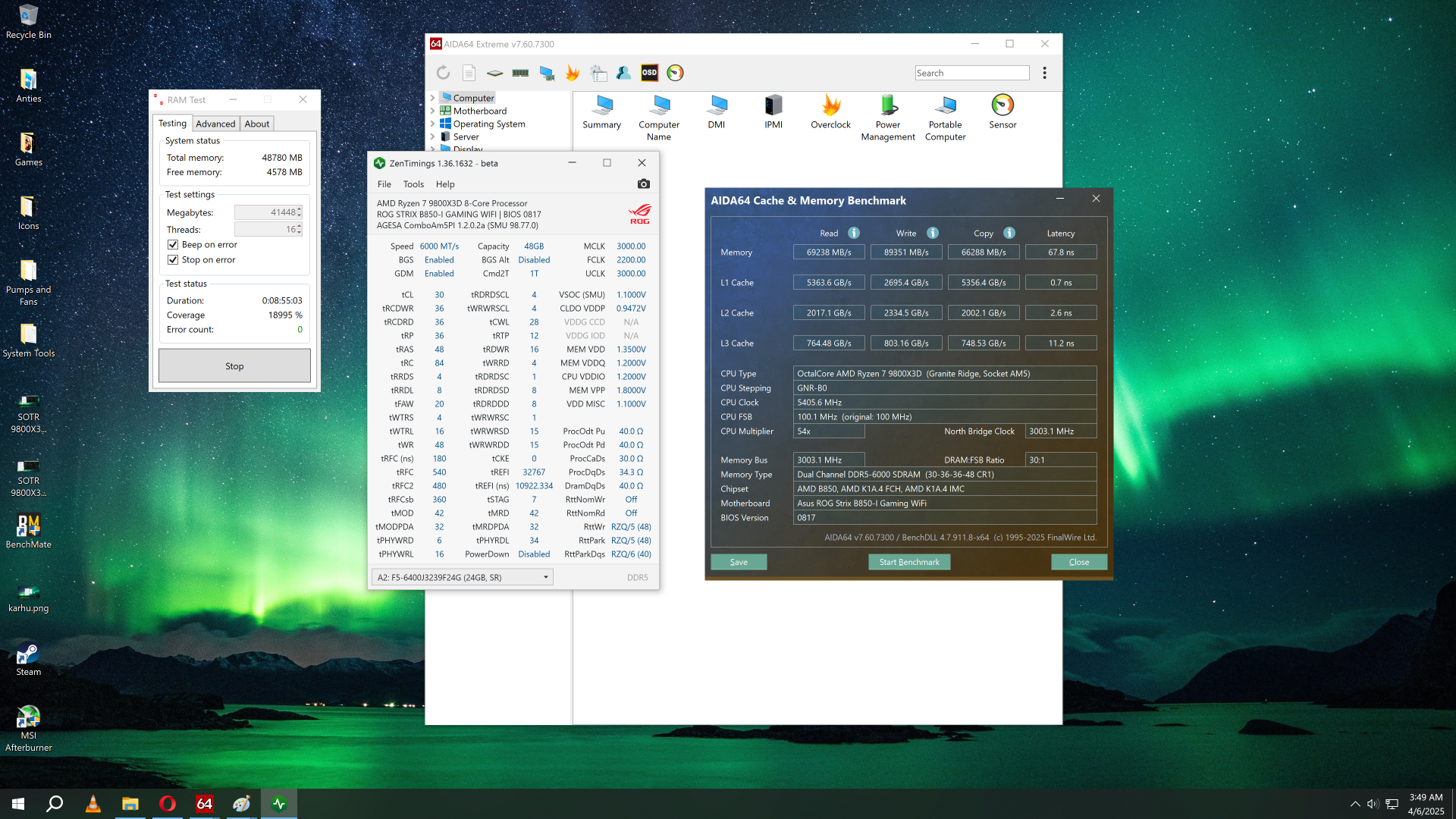

it's Micron.You can probably go tighter on the timings if it's Hynix memory. Just finished stress testing 6000CL30 with low voltages and 2200 FCLK. G.Skill 6400C32 kit.

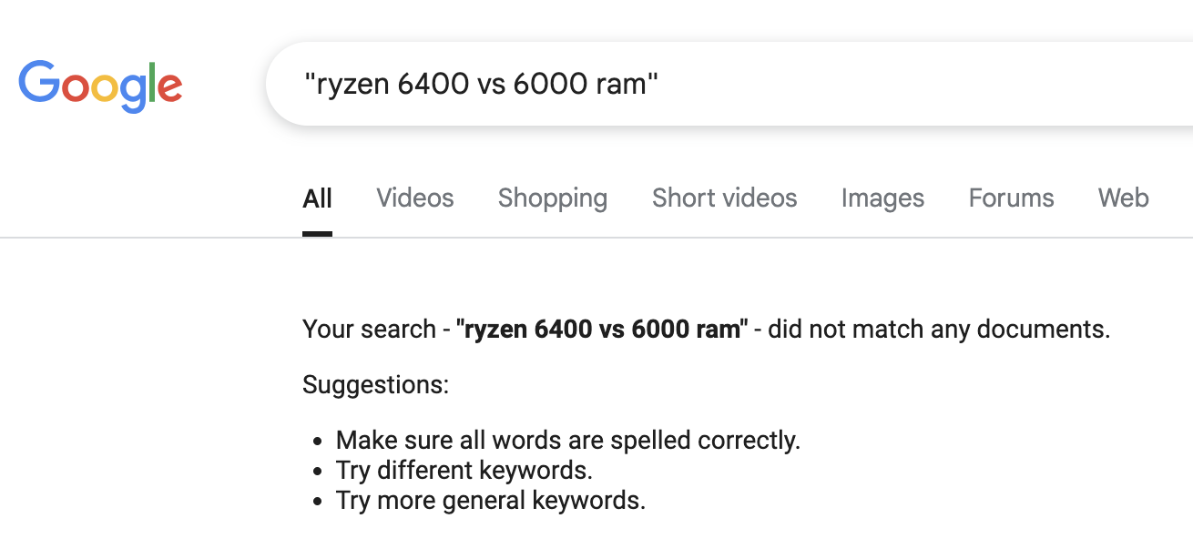

It's really easy to look it up:So it is 0.5-2.0% for 6000 vs 8000, but there's still no numbers for 6000 1:1 vs 6400 1:2?
https://www.google.com/search?q=ryz...e=UTF-8&oe=UTF-8&hl=en-us&client=safari&iga=1
