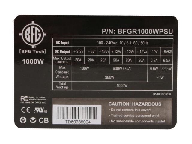

It has 2 12v rails 1 16a the other 18a I believe... 34 A isnt enough? I mean I saw a really nice 120 A PSU hehe, but its super expensive :(

The specs are mean, its the best bang for the buck I can find. most other 1KW PSU's are in the 300+ range.
It has 6 12 V rails I believe all rated at 20a a piece. Thats like 120A total, which is freaking sick!
Just to clarify, its only gonna suck up what is in use, so like its not going to be sucking 1000w and 120a all the time right :)
Sorry, it is 80A. Theres the specs for the most part.

Only if you stay within the optimal power consumption range.
In that range you can expect efficiency to be around 70 to 80%.
If you draw too little or too much current you will go outside that range and efficiency will drop.
It is a bit of overkill even for 1 8800GTX !
A good 700W PSU will be perfect.
edit:
if your 1000W PSU is maxed out and efficiency drops to 60%, that will be using 1.6KW from the mains !!
You might not wanna max that one ;)
120A on the 12V rails of a 1000W PSU is impossible. That alone is 1440W.
The absolute maximum current on 12V rails of a 1000W PSU is 83.3, but that would leave none for the 5V and 3.3V. 75A is nearing the actual maximum. Not bad, but definitely overkill for one 8800 GTX.
A good 700W PSU will run two 8800 GTX's and all the latest gear.

1. Rails do NOT add. That is why dual 20a power supplies almost NEVER = 40a. it just doesn't work.
2. Ditch the BFG. better choices for less.
3. Ditch the FSP. Better choices all around.
