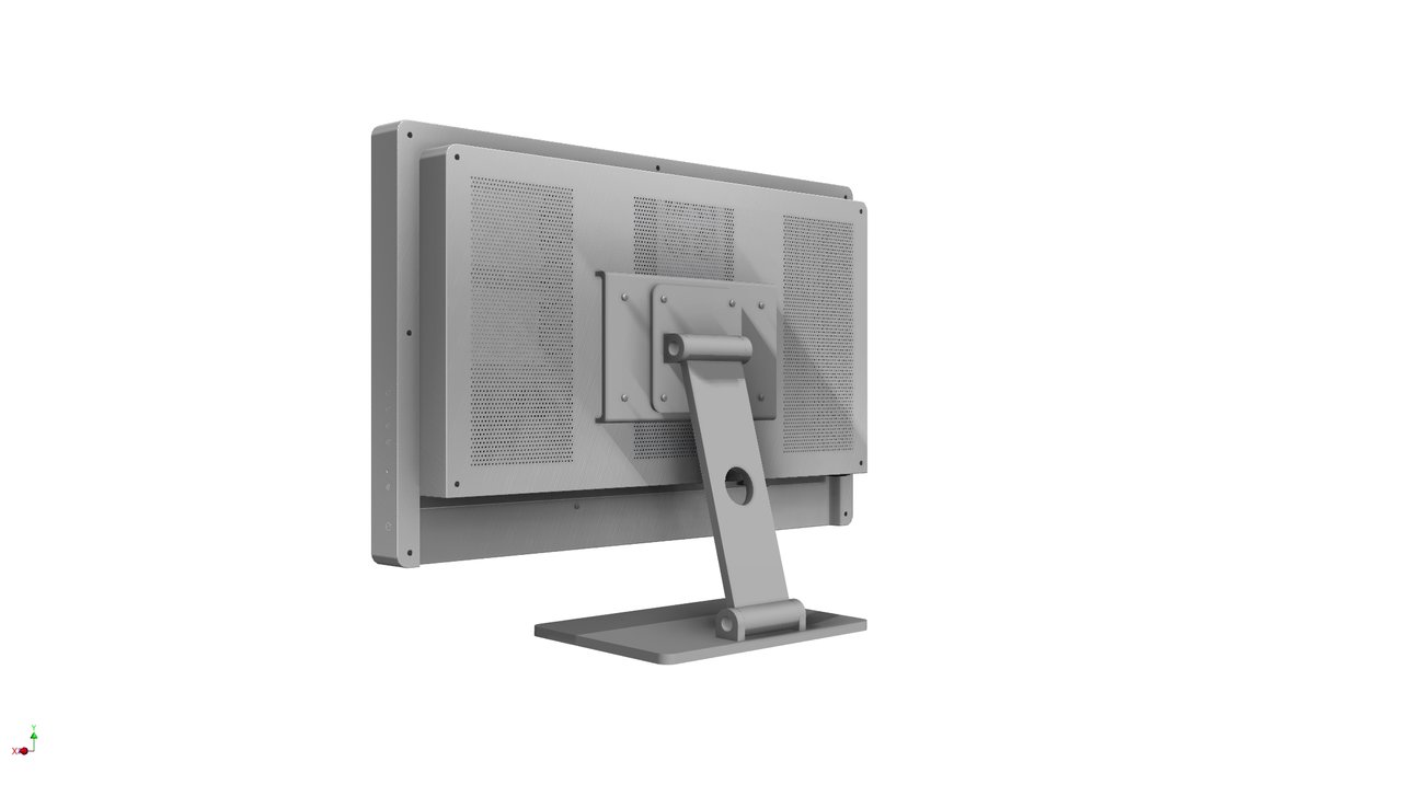

So I'll start with the outer design. My concept was total customization. This means that all internal parts and casing can be changed. I guess the casing would be more difficult as people will need to make one to fit the chassis but never the less I wanted something more open. I also wanted something that could double as a TV with built in sound.
I chose 27 inches as my go to monitor. I bought some LG panels for cheap (one used in the older non retina Imac) with specifications and found that most panels makers stick to a standard except for Samsung. Where they differ is usually in thickness and bezel.

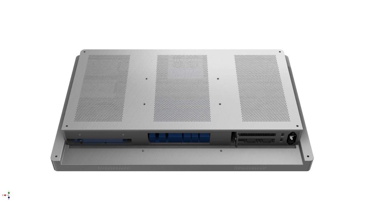

This back bottom shows how it would look. Middle is an ITX board. To the right is a graphics card and on the left an AD board to control monitor input. As you can see, a cable will need to actually link from the video source to the AD board. Add a audio cable to that mix if you don't plan on HDMI connection and want to use the built in speakers.
Definitely not the most elegant solution, but I think it was a decent trade off for having the ability to buy off the shelf parts. The 4 holes in the middle are for a standard vesa mount. I went with the 200 x 100 mm specs as it fit my internals (shown below) but also because it seems that the standard for this size.
I added the controls to the side. This is based on the AD card's input controller board I had on hand. The bottom is the power button. This can change based on case design. There is space around the rims.
On the other side is basic inputs like usb and audio. There is actually space in the bottom front portion as well to add controls.

Finally, the middle bars are used to allow the vesa mount as well as providing support to the chassis.

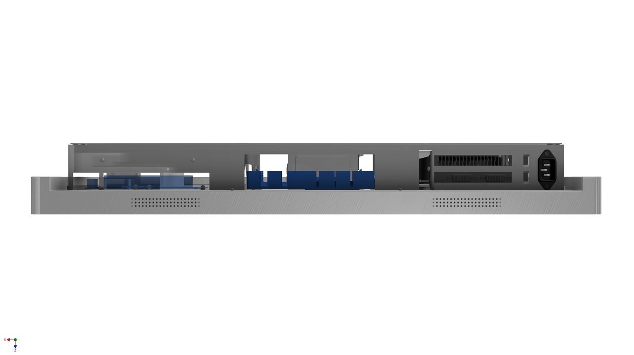

A view from the side showing how thick this would be. I'll need to redownload inventor student addition to see exactly the thickness but I think it was about 8.4 cm (3.3 inches). The thickness was based on the Imac panel I had which happens to be the thickest as it would fit a variety of 27 inch panels. Using a slim panel can probably shave 0.5cm from the design.

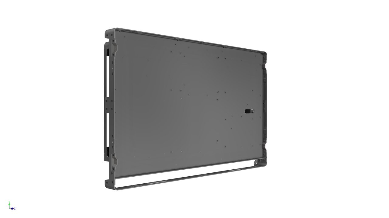

Here it is minus the lcd panel. The whole thing was designed with the sheet metal and stamping/folding process. I originally designed it with machined parts but it would have been prohibitively expensive.

The current thickness is unfortunately completely dependent on the height of the SFX PSU. I tested a flexATX PSU in the design as well but found that it just didn't have the mass appeal or availability compared to the SFX. The only other way to make it any thinner is by using a thinner or slim LCD panel which is much more readily available compared to 2 years ago in terms of quality and price.
