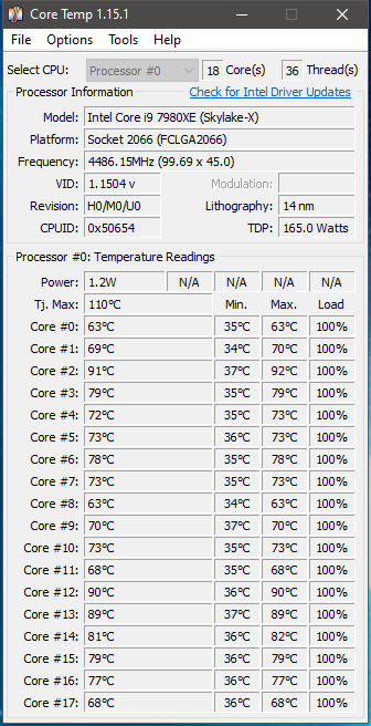

Temps are varying wildly between cores some are 20c-50c its been delidded and relidded im not 100% if it was superglue or tha gasket sealer.

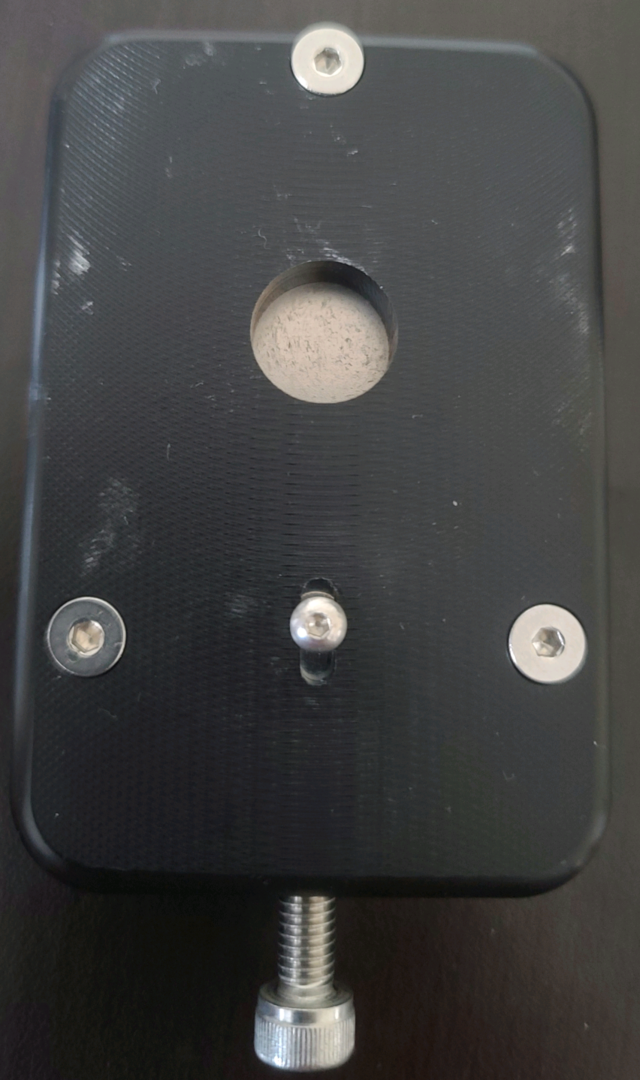

i have a 7900x incase this goes sideways also i fi does i got a new keychain

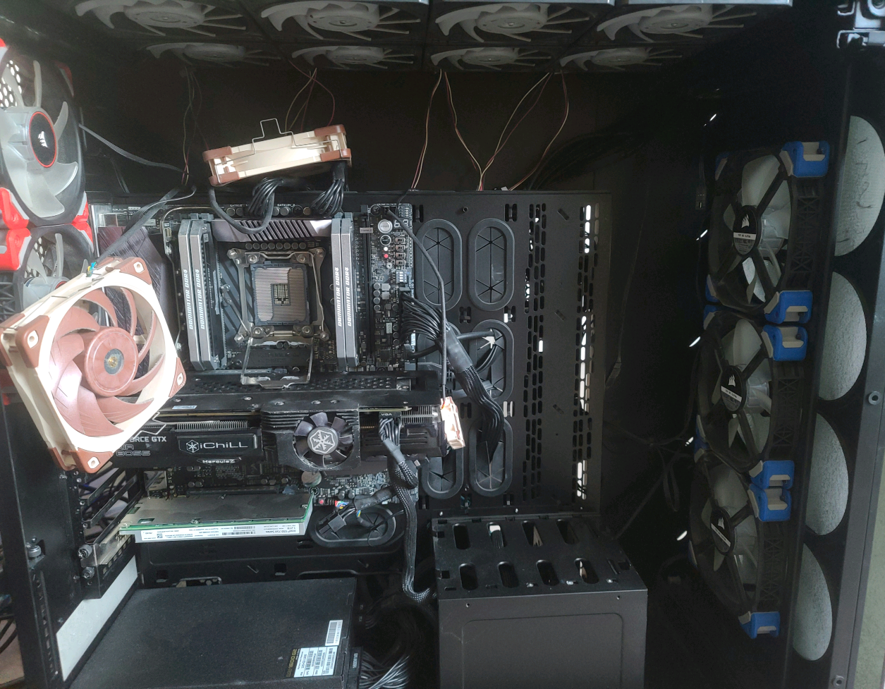

would it matter what it was relidded with i bought htis 2nd hand from a extreme ocer yrs ago. and at first temps were amazing but as time went on it crept up. the cooler im using is the NH-U12A in the corsiar 1000D i have 8 GT 120 fans up top exhausting air like mad. but im guessin this thing just cant keep up anymore, ill see what happens at default settings, when under load. then tune a nice oc in with stable voltages.

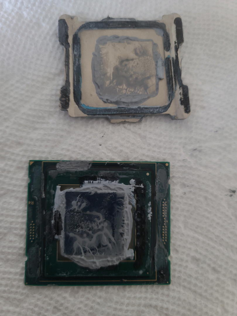

welp i found the issue i was told it was LM well i delidded it myself, this is what i found

load temps would instantly hit 110c on 8-10 cores now its below that and doesnt downclock.
yeah it was like thin runny too im waiting on a direct die kit. but in mean time i used that really pricey kroknaut $161 for 33g lol on the outside IHS.

WTF!? why would they go to all the trouble of delidding it only to completely fuck it up? What a meathead. Well at least they sealed it up so the tim didnt leak all over the socket and get into the pins.
And now that you know what NOT to do haha.
Dude return that shit its only $115 at amazon!
