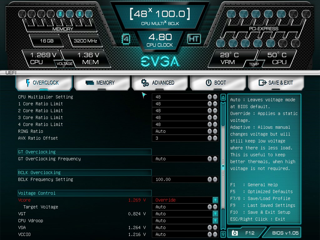

Just recently built this new PC and haven't had a new PC since my old Q6600 CPU. Coming into the new PC market again (very horrible time to get back in lol) and don't know what to look for with the new hardware. Still don't have a GPU yet and currently running off of the Intel Graphics. Hitting 88C - 90C @ 5.0GHz at full load with a Cooler Master Hyper when running Cinebench (will be getting a Corsair Hydro H150i PRO soon). 32C - 35C Idle on High Performance mode. Is this any good? Motherboard is an EVGA Z270 FTWK.

seems too hot, Cinebench is a very light load compared to, say, Prime95 or an encoder. you really don't want to run 90C at the elevated voltages required to reach 5Ghz, it will degrade your chip over time.

I've been running 1.3V on all my Skylake/Kaby Lake systems with good success, usually good for 4.6-4.7GHz on Skylake and 4.8-4.9Ghz on Kaby Lake. 5Ghz is a push and requires some aggressive cooling, certainly not worth it for daily driver use as it is only a couple percent improvement over 4.8GHz.

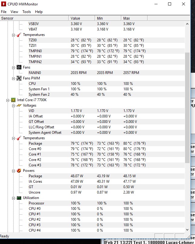

Heres what im getting in HWMonitor when I run Prime95. I lowered it to 4.6GHz then 4.5GHz. Is it better to run it on High Performance mode or Balanced? Do I have to turn on or off any CPU features in the BIOS or leave it as default? How long would you run Prime95 for? When I run Prime95 the CPU speed goes down from 4.5GHz to 4.2GHz then after the tests it goes back to 4.5GHz why is that?

Was going to tell you that the new CPUs have AVX and run hot, the bios also has an AVX offset to reduce cpu speed when AVX is used. This is exactly why you only get 4.2 in P95, your AVX set to offset -3
Anyway the Newest P95 has avx
The older version 26.6? Is non avx and represents more normal load
Many boards overvolted vcore also, so you should check it
You will prob have to settle for 4.7 with that cooler and -3/-4 avx offset. Test both versions of p95 for temps and see if you can lower vcore to help
My 7700k I settled for 4.8 hits 80+ on p95 non avx and -1 avx offset so 4.7 with avx hitting 85 on p95 with avx

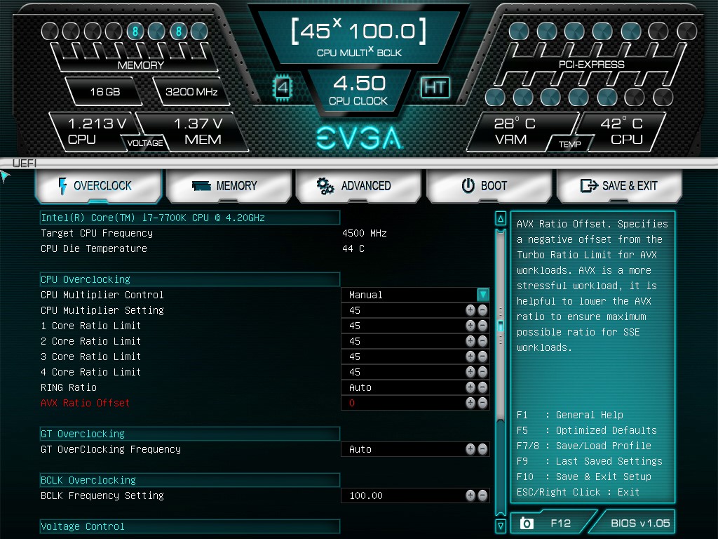

Thanks a lot for the reply I tried to offset the AVX in BIOS to -3 but it doesn't go below 0.

It will be a positive number but will reduce cpu speed. So 3 would mean -3(from the multiplier).
So you would end up 4.5 non avx like gaming and 4.2 avx

Oh ok well by default it is +3 and thats what I have been using. So should I keep it at +3?

Yes that's what I assumed. +3 is what many use and should work fine.

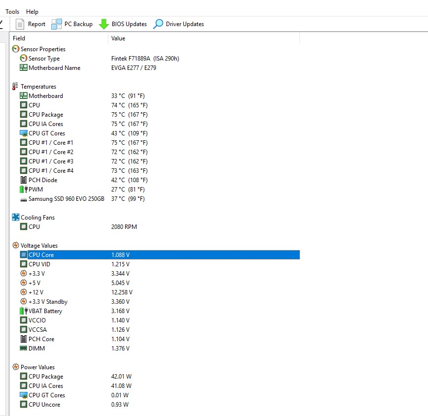

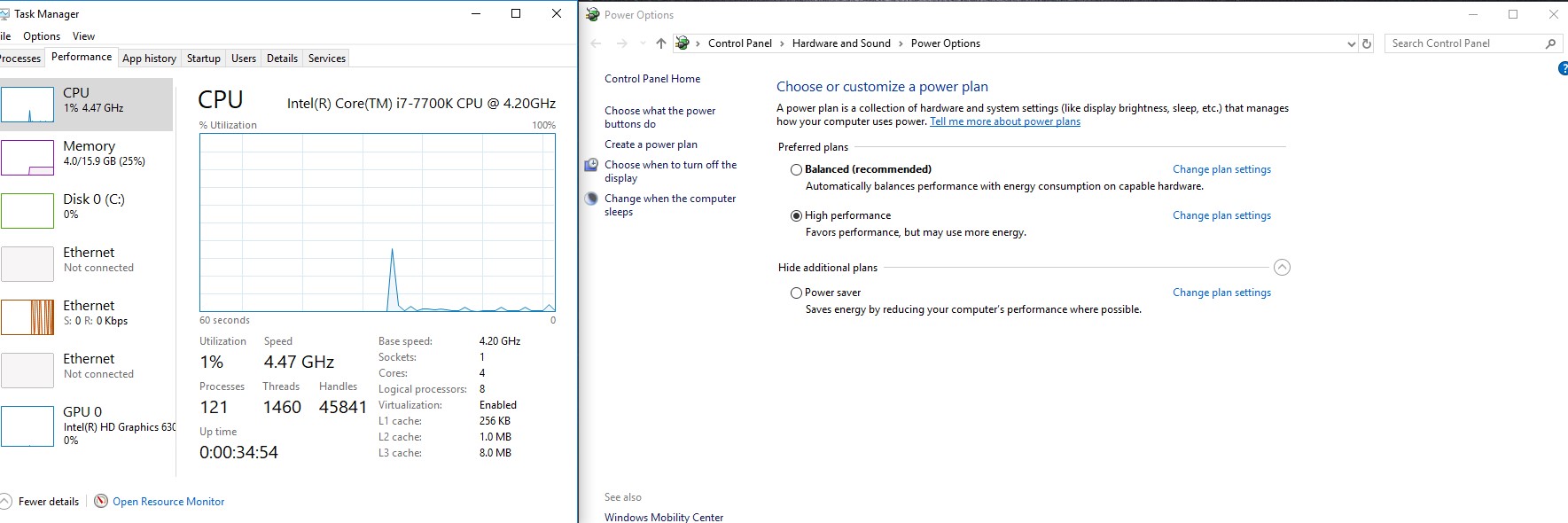

It seems that if I put it on High Performance Mode it keeps it at the speed you set it in BIOS when idle.
Yes, it will do it automatically if your doing something demanding. I do that when gaming so it won't try and lower.
You can use those for a few neat things. I have mine so power saver is locket at 40% cpu which=1.7ghz, for downloading. Then I set balanced to go from 1.7(40%) up to 3.5(85%)

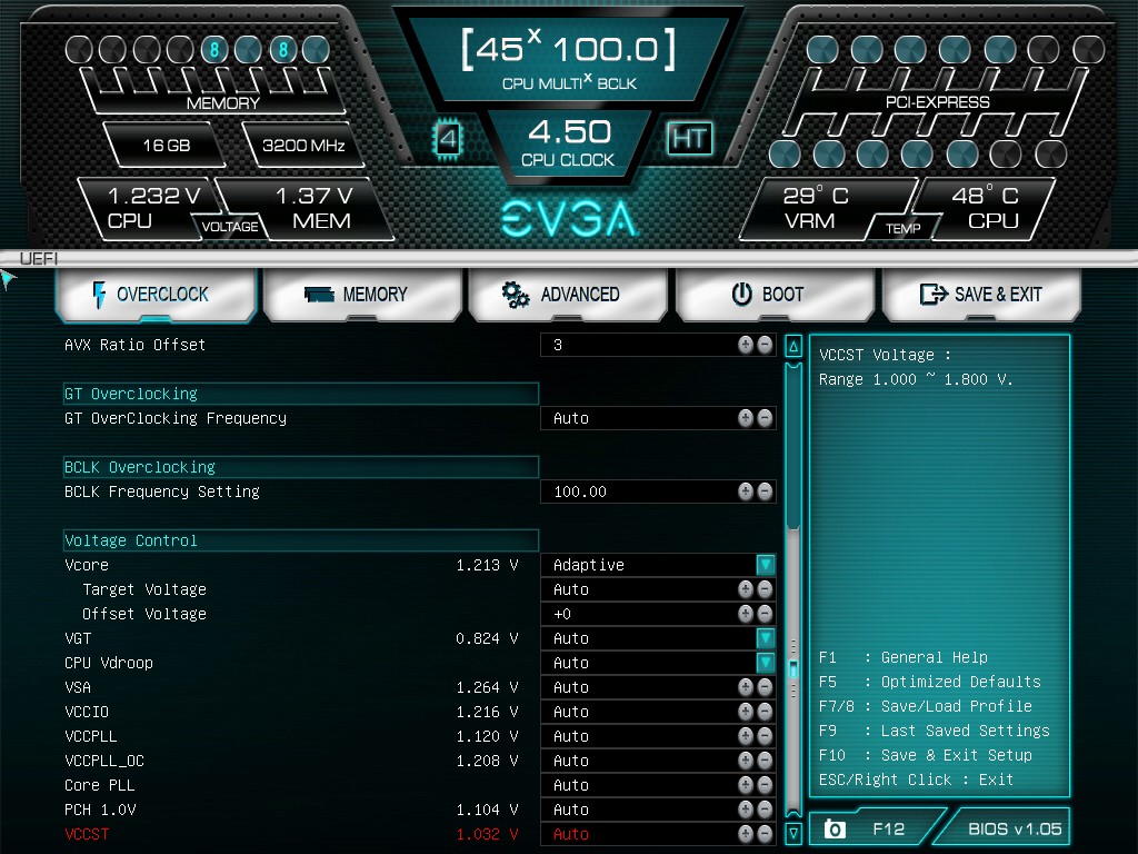

Do I override the vcore or put it on adaptive?
Try adaptive if you want to keep the stock power management (lowering clocks and vcore at idle)
Then you should have an option for offset, this is where you can add or subtract vcore, and play with LLC.
Mine overvolted with adaptive to like 1.33v so I ended up with -.050v offset. Yours may be as it should so you may have to have a plus offset to get it to 1.28v
Basically just set to adaptive and 4.5ghz and run p95 and look what the vcore is( not the vid as it's a separate reading), and go from there

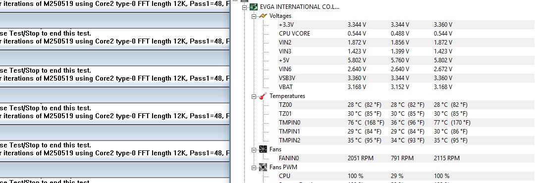

CPU in BIOS is on adaptive and bounces from 0.536 to 0.544 but stays on 0.544 longest while running Prime95. Why am I only getting half a volt in HWMonitor?

Seems that the program isn't reporting correctly for my motherboard. Anyway to get the correct voltage reading? I dont know what to really look for.. CPU VCORE only shows 0.544v at full load...

How do I get the program to report the correct voltage since its on Auto in BIOS? I wanted to know what its giving on Auto.
