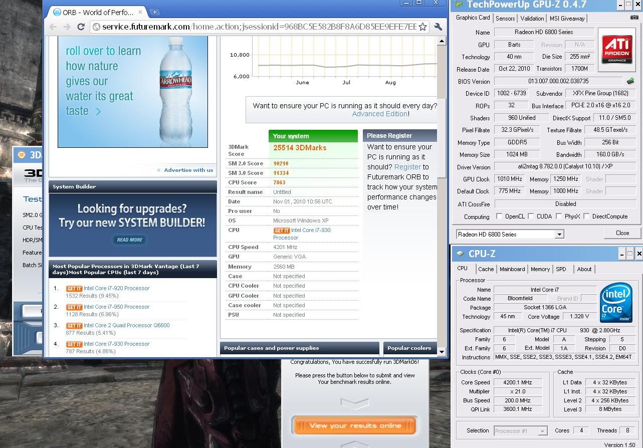

Just played UT3 for about an hour straight with HD6850 on Windows XP SP3 over clocked to 1010/1250. i7-930 was at 4.2GHZ. Looked and played great in DX9.
Next upgrade for over clocking this card would be an improved heat sink. Great video card.

Migh be heat sink is not seated right or thermal paste is not good. These cards are very touchy hot when increasing voltage. XFX HD6850 has a decent heat sink and that is why I thimk mine over clocks well. I think a good heatsink wil help oc out.
