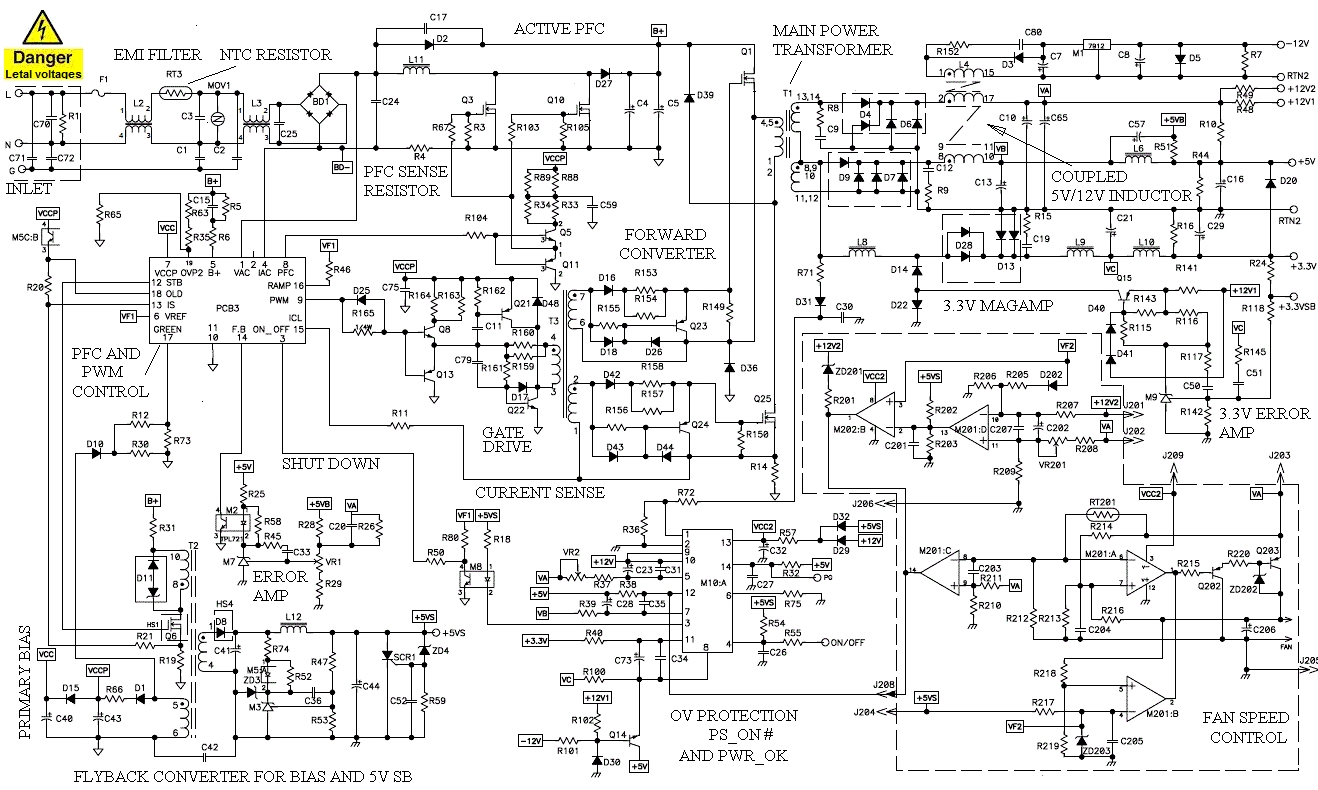

The lower bottom of the PSU schematic is 5vSB. The grey wire (pin 8) power good, or the PSU drops out. An Orcad technician can route a PSU and make it usually
in a few hours. Usually, to make it, it goes to China. Should be several hundred dollars apiece for a make.
What is the function of +5 SB pin ATX power supply? Voltage Drop to an Electrician is the formula concerning high amperage draw, conductor
size & the resistance caused when high amperage draws current. They therefore use larger conductors when the length of the wires becomes excessive.
When a circuit is being pulled down the function of Stand By, is to bias with a little more voltage as if an electrolytic capacitor for EMF storage was available.
Burning out this circuit could be when a for some reason there was excessive load on a 3.3 V supply.
The ATX connector provides multiple wires and power connections for the 3.3 V supply because it is most sensitive to voltage drop in the supply connections. Another ATX addition was the +5 V SB (standby) rail for providing a small amount of standby power, even when the computer was nominally "off".
