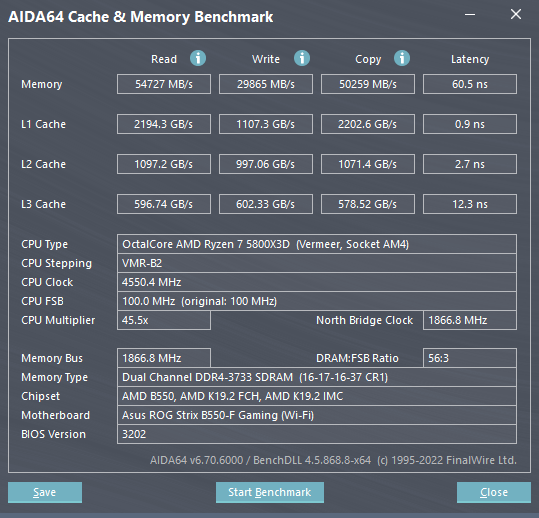

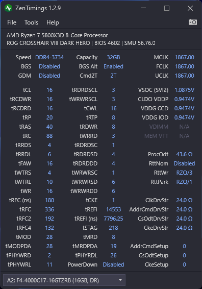

Here's mine. I settled for 1866. FCLK 1900 is a black hole. Anything above that is WHEA central

Here's mine. I settled for 1833. FCLK 1900 is a black hole. Anything above that is WHEA central
View attachment 596201View attachment 596202

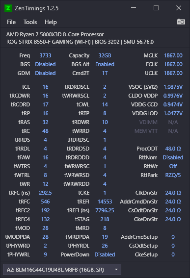

I am working my way through tightening timings right now, here is where I am at. Congrats on 1T. I couldn't get it to post with 1T so far. Might try some tweaks at the end once I get timings dialed in.
Try enabling the default DOCP ram timings. I started from there and started tightening the primary timings until I found a stable spot. Then the secondary timings. Mine defaulted to GDM off and 1T so I left it at that.
There's a chart for setting the TRFC.
DOCP on my kit is 4000 and it boots fine and seems to run fine, but whea-19s all over. I am working my way through this guide now. Each step I keep seeing improvements, so I probably won't worry about 1T vs 2T.

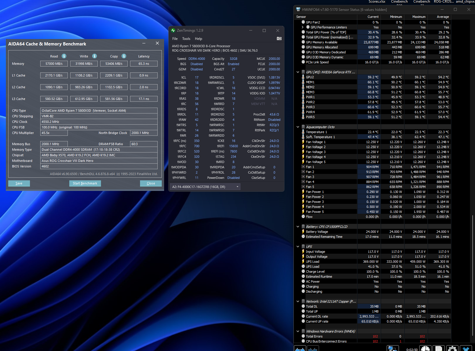

There was a guy at OCN, had a nice LC setup, but his temps were worse than mine.. here is after a Cinebench 2024 run..
I just noticed I am not runnning 2T like I thought I was lol.. should have been flat 15s.. dam noobs :)
