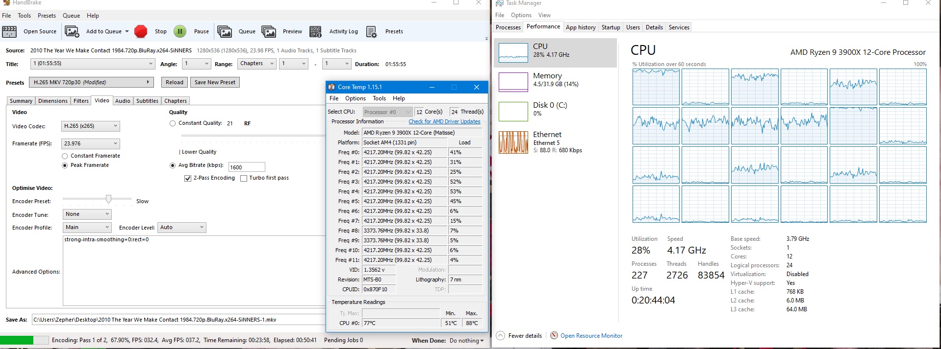

Is there a reason why Handbrake is only using around 40% of the 3900X during an X265 encode?
And are the temps I am seeing with HW Monitor and CoreTemp correct? Seems kinda high at 70+ C with only 40% load on the processor, and the max was 88*C according to CoreTemp.
Is it maybe throttling due to temps. I told my friend that we may need to get an aftermarket cooler for his 3900X setup, either a Noctua Air cooler or Corsair AIO. He's going to decide in a day or so which one to get.

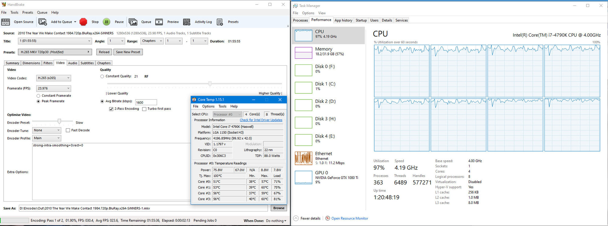

I ran the same test with the same settings on my 4790k and Handbrake uses over 90% of the CPU.

Your running two pass encodes. The first pass always does that. It doesn't fully loaded the CPU. On the second pass you should see much better loading of the CPU.
Two pass is kind of old school. You should try playing with the constant quality slider. The whole video won't be locked into a single bitrate. And it will be a one pass encode.
handbrake has issues scaling over 8 threads which is what you're hitting so you might need to mess with it some to get it to scale beyond that. been years since i messed with it though.

I was playing around with the affinity settings on the 3900X and it didn't really seem to change, lowered it to 12 and 16 threads, it would just use less threads but the other threads weren't ramping up.
I'll try it again and lower it down to 8 threads and see what happens.

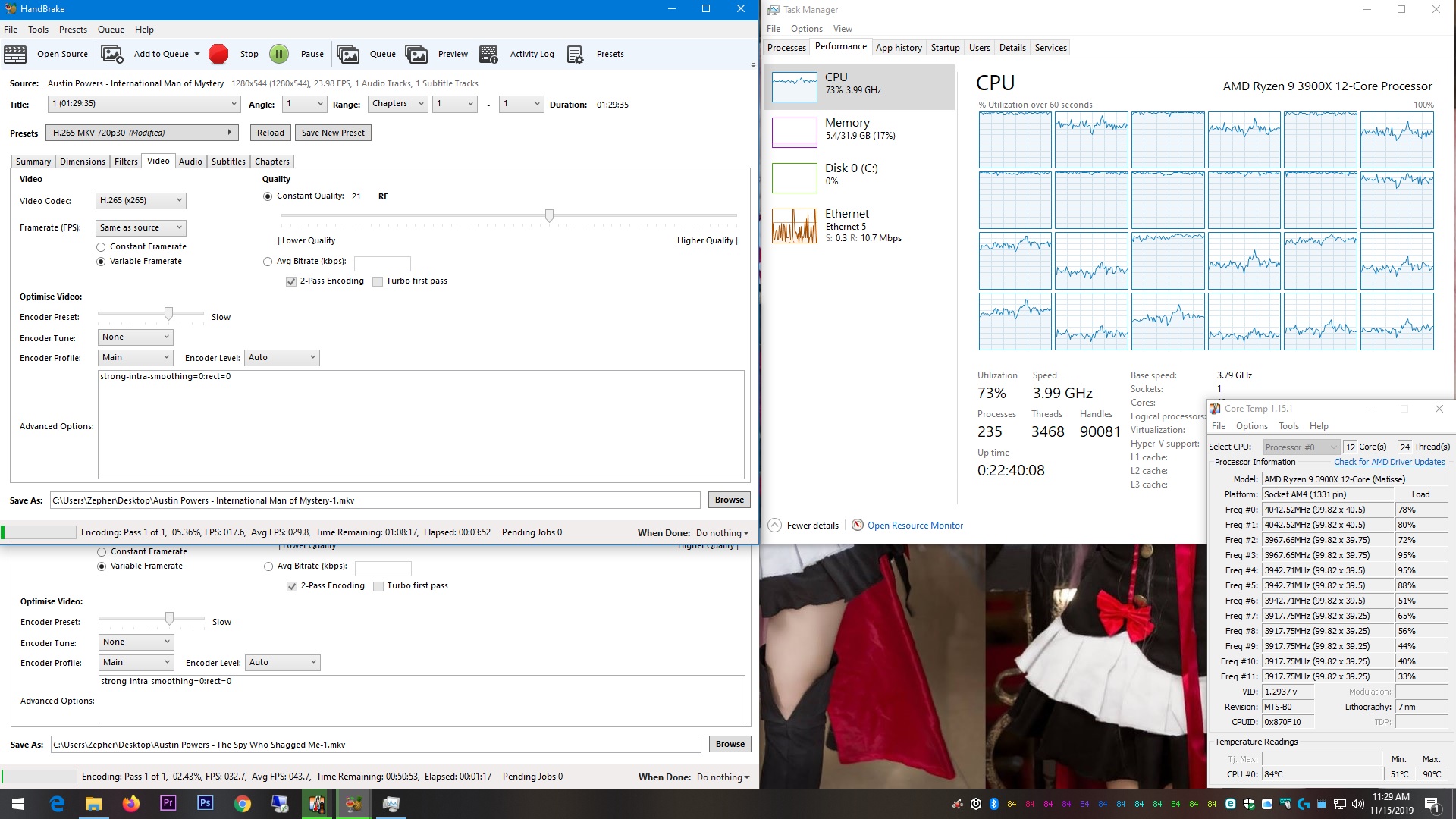

I loaded up 2 instances, single pass x265, and set 12 threads for each and it loads up to 75% of the CPU, but coretemp shows 85*C.

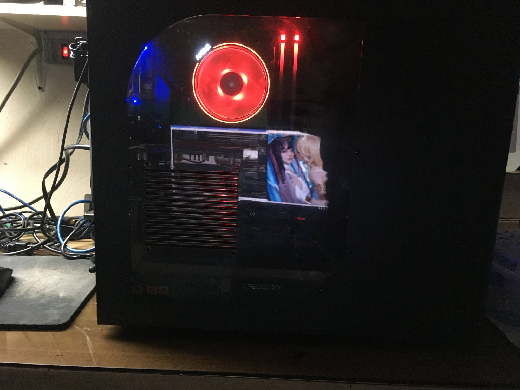

So I guess the stock cooler isn't adequate for this CPU, it does look pretty though with the fancy colors, lol.
AIO I guess unless there is something going on with your cooling. Max out your cpu fan profile, take the case side off, double check your cpu mount, double check case fan orientation in front out the back or at least Have a methodology to the airflow whatever it is.

fans are correct, this is temporary case, will be going into a Thermaltake Level 20 mid tower when I get my friends OS migrated to this machine.
I'll try new thermal paste and see if that improves it, otherwise going with new Air cooler or AIO.

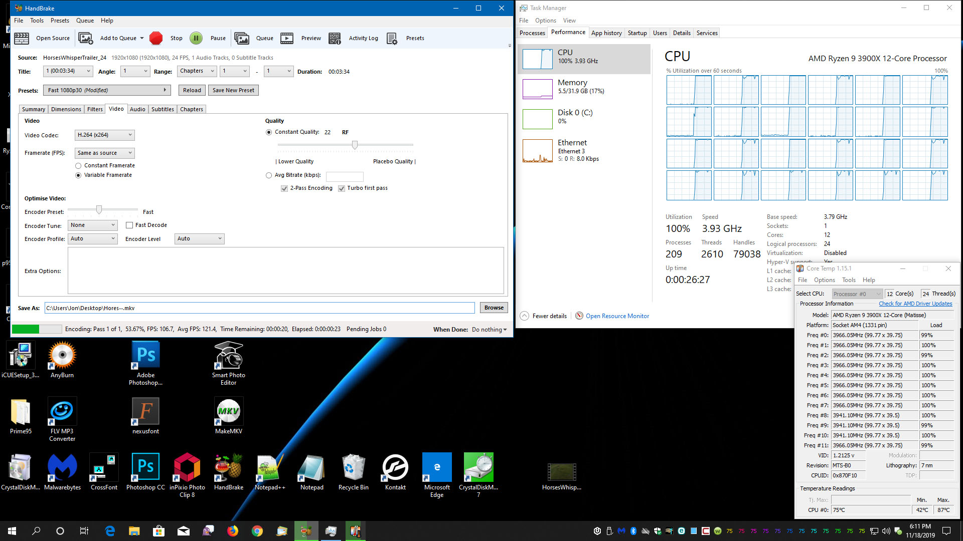

My friend wanted me to run a test on the machine so he can compare it to his 4770 machine.
Handbrake uses all threads with the H264 codec. His 4770 took almost 2.5 minutes to render and this one took 35-40 seconds to render.
He said that that speed increase makes the upgrade expense worth it.

Might be a 264 vs 265 thing.

2 more Differences from the OP.
1: You are at higher resolution. Higher resolution is allows more blocks per/frame, so more threads can be utilized fully.
2: You are using constant quality (better choice), and the OP is using Two Pass.
I just did x265 with both constant quality and 2 pass, and still only get 55-70%. Like mentioned in earlier posts, the x265 encoder in Handbrake doesn't seem to scale well.

Have you tried a higher resolution file/output? Find a 4K sample somewhere and re-encode without resize.
