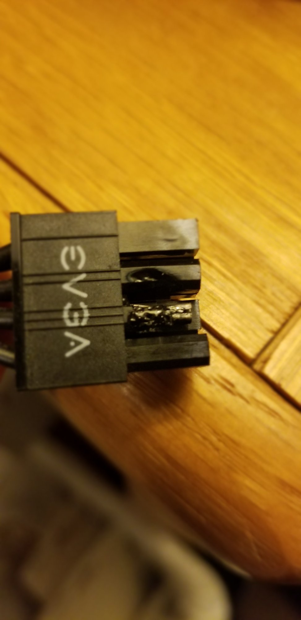

I think I found the culprit...
A burnt 8 pin? But AMDs marketing told us that 8 pins were safe!
But really, I would contact EVGA to see if they will replace it, before they go under.
I was mystified too. It isnt like anything I do would pull that much power. Not only that, I was using two connections from the psu to the gpu.
