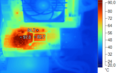

When did 100°C become a deal breaker for VRM temps ("insanely high")? I can remember posting this info in the past and being told it's nothing because VRM's are spec'd to 125°C. Now that we have AMD cards pushing 100°C it's a game stopper? How come?
Source: Hardware.fr
Gainward 580 Phantom
Gigabyte 580 SOC
Zotac 580 Amp²
GTX 690
Even little old 660 ti runs close to 100°C
Asus 660 ti DCII Top
EVGA 660 ti SC

VRMs are usually spec'd to run 120C+.
My car's engine is spec'd to run up to 6800RPM but that doesn't mean the manufacturer gives you an okay to drive around full throttle in second gear all day.
Hope for you it's a lease or you have a fund set up for new tranny. Maybe that's why people steer clear of used GPUs for mining.
What the fuck does running the engine at 6800 all day have to do with the tranny. He said Second Gear, so it's not like its even shifting at that RPM. He's either A: got it locked in L or 2 on an auto, or B: Drives a stick, like a real man. When the timing belt snaps and the pistons bend all the valves, or he spins a bearing or two in the bottom end, that's when he'll need to spend the money for running the car at red line all day. Shit, my S2000 loved 9k rpms.
VRMs are specced to goto 125c. If VRM temps are restricting your OC, go with a board with a beefier VRM setup. No one is holding a gun to your head saying buy XFX. XFX built the card to run at the settings they specify. If it's under 100c at those settings, I'd say they engineered the card just dandy.
Comprehension...
125C is max and if you drive it at max all the time it means more prone to failure and shorter life.
People care because there are variations out XFX out there that run much lower VRM temp. Same reason you would care about if your S2000 has a defect where it runs hotter than normal and less optimally.
