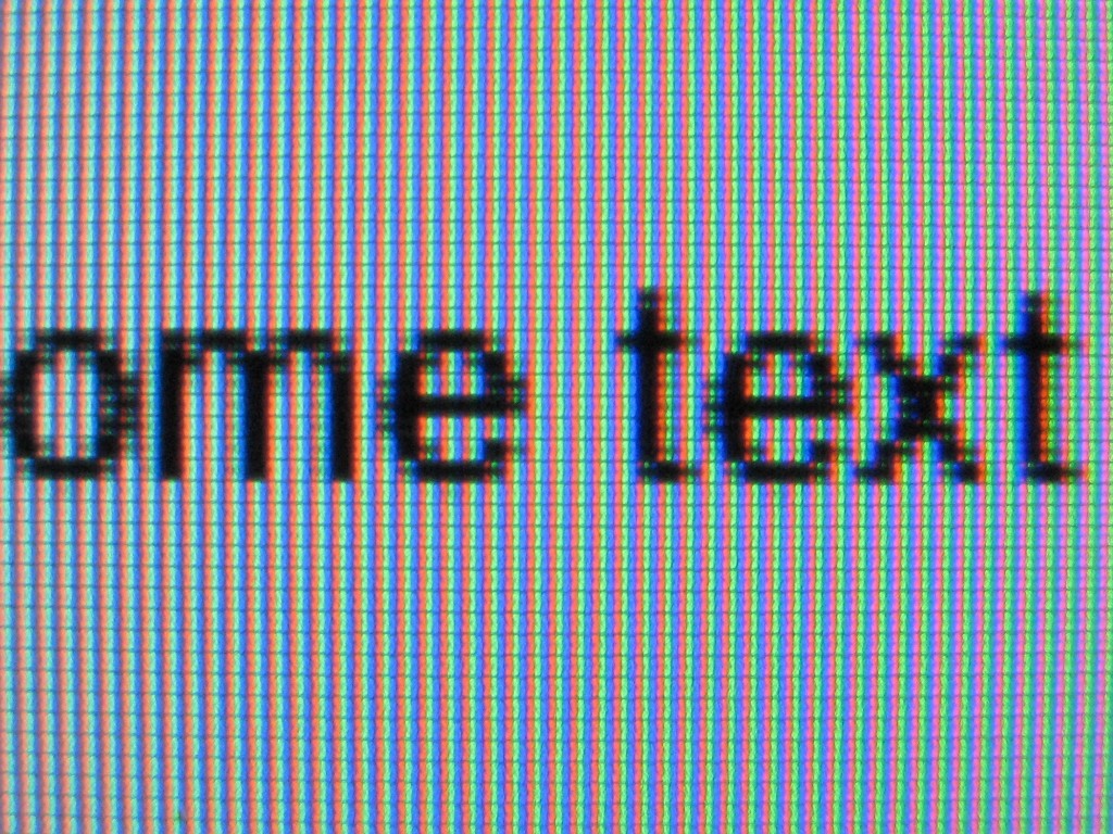

Can you take a macro shot of the pixels on each monitor? Take a picture of these emoticons: :cool::p;)

I asked for a macro shot because I wanted to see how the pixels were structured.
I have the answer to why text is blurry. Someone posted a macro shot of the LG in the LG thread:
Blue Falcon said:
I haven't tried the LG, but I tried another monitor (EIZO HD2441W) with a similar pixel structure, and it ruined text quality for me. When I put my face up to the screen, I could see each pixel was made up of two smaller pixels, and for darker colors, only the top and bottom of the pixel are lit. This caused my eyes to blend the bottom of one pixel and the top of another pixel together, which resulted in a slight vertical blur and messed up antialiased text. That's exactly what that image shows.

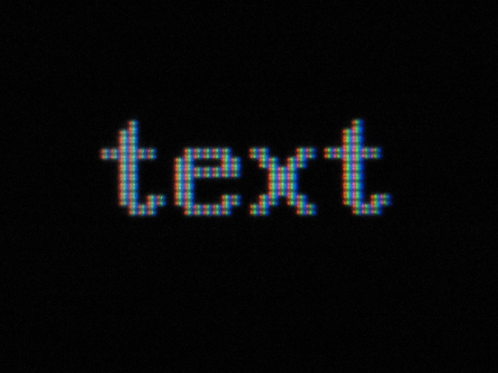

Here is a picture of light gray text on a black background:
I chose a blurry picture to show what my eyes see. Notice how it looks like the pixel grid is IN the pixels instead of between the pixels.
Here is a picture of antialiased text on a white background:
Notice how the pixels look similar to the LG except facing the other direction. The gaps in the pixels mess up antialiased text.
Everything on the EIZO looked slightly fuzzy to me, which ruined text quality for me, and based on the pictures, it looks like the 24" LG is the same way. The 22" LG is sharper because it has a TN panel, which doesn't have pixels like that.
Using ClearType Tuner can make the text look a bit sharper on P-MVA panels. It won't perform miracles but it can help. I sit about 3' from mine, and even with the default ClearType setting text looks very good but not razor sharp. I'd rather have less sharp text over poor viewing angles.
It seems with every LCD panel tech there are some trade-offs.
ClearType doesn't really help because the gap in the pixels with darker colors screws up antialiasing.
What bothers me is this is a new thing. The EIZO supposedly has a newer S-PVA panel, which has the same problem. Older VA panels weren't like this. That's why elazarus isn't bothered by the Dell.
Engineers must be blind. Whose bright idea was it to only light the top and bottom of a pixel for darker colors? What does that achieve? Why couldn't they light the middle of the pixel instead to do what they wanted to do? That would have avoided the blur.
