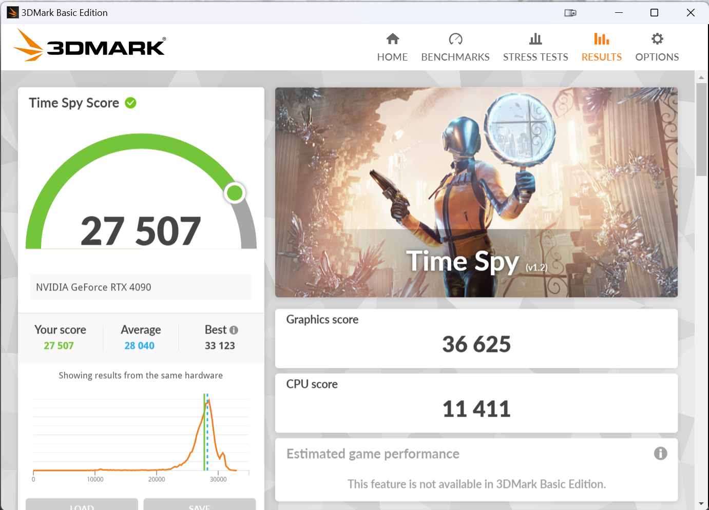

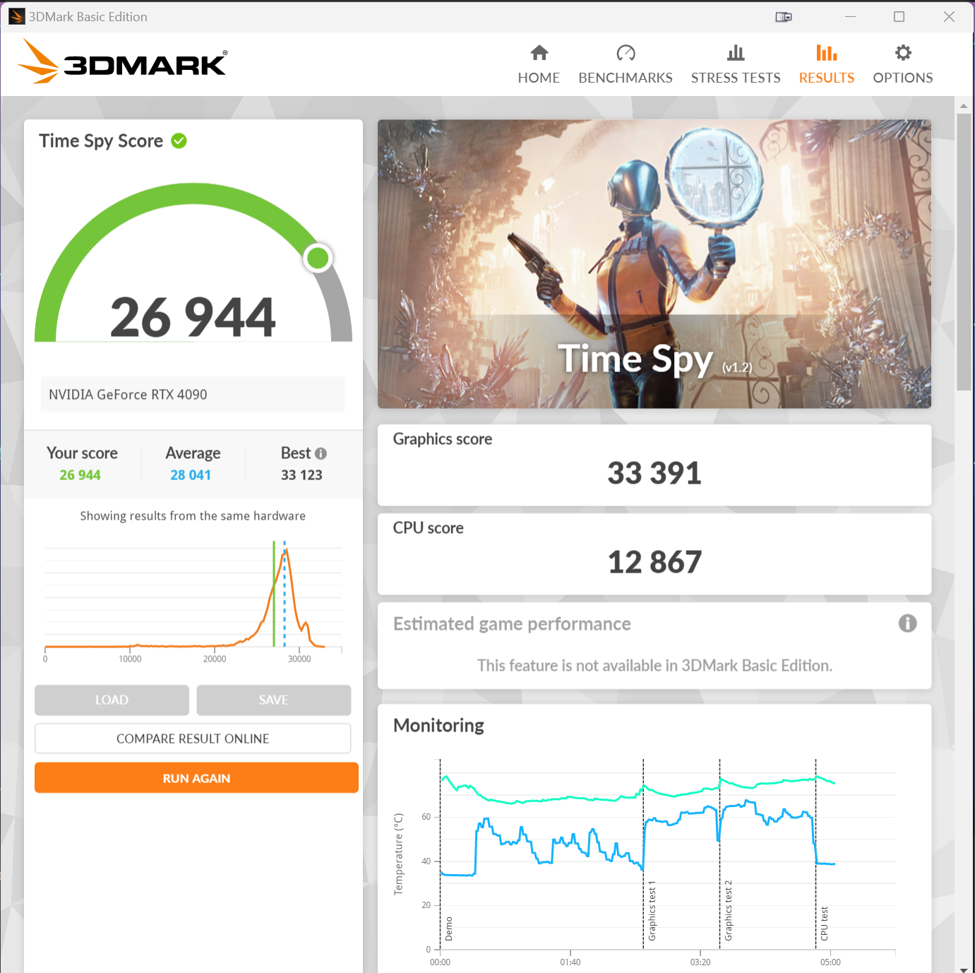

Lots of good info in this thread. After reading through it, I ran Time Spy on my system (5900X and 4090) and discovered my graphics score was also a bit low.
Here's my starting point:
After some tweaking, I ended up here:

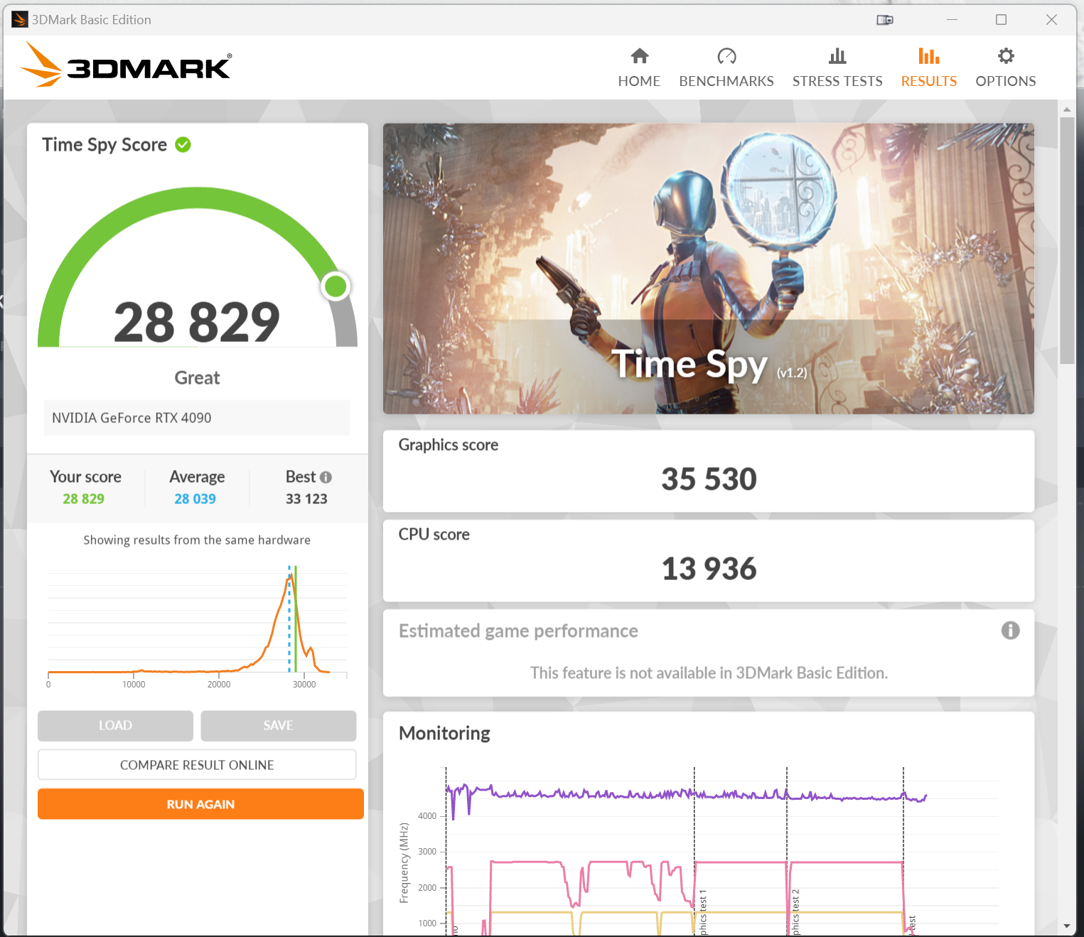

SMT on: 28,829 overall score; 35,530 graphics score; 13,939 CPU score.

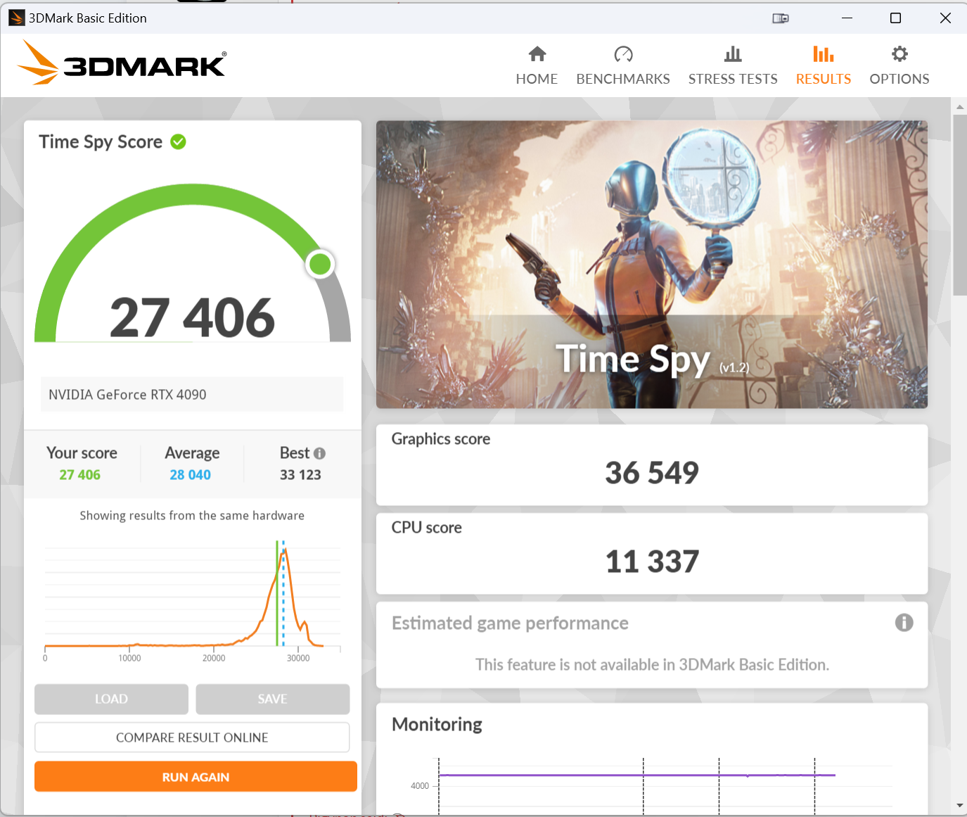

SMT off:
Very interesting results with SMT off. CPU score takes a significant hit, but GPU score gets a boost. Most exciting, my GPU utilization is hitting 100% so I think you're on to something with the stuttering. Played a couple hours of Cyberpunk after turning SMT off last night and it was nice and smooth. Would have to switch back and forth to say for sure if I notice any hitching with SMT on.
SMT off:
