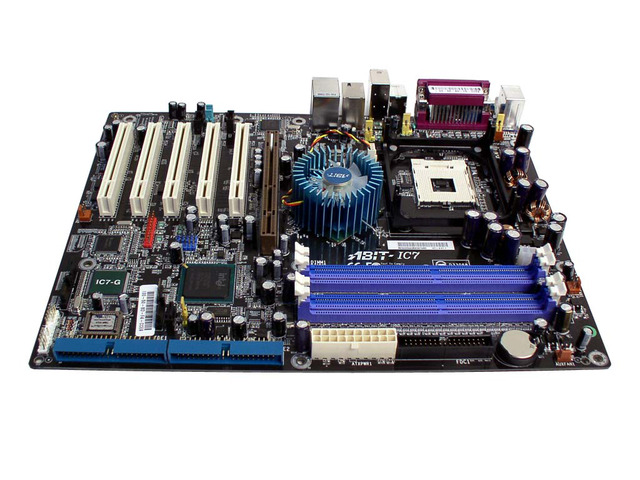

Could it be the stock Northbridge cooler? If so can anyone reccomend a decent cooler which will fit with the two hook design of the IC7-G (as seen here http://images10.newegg.com/productimage/13-127-152-14.JPG)
