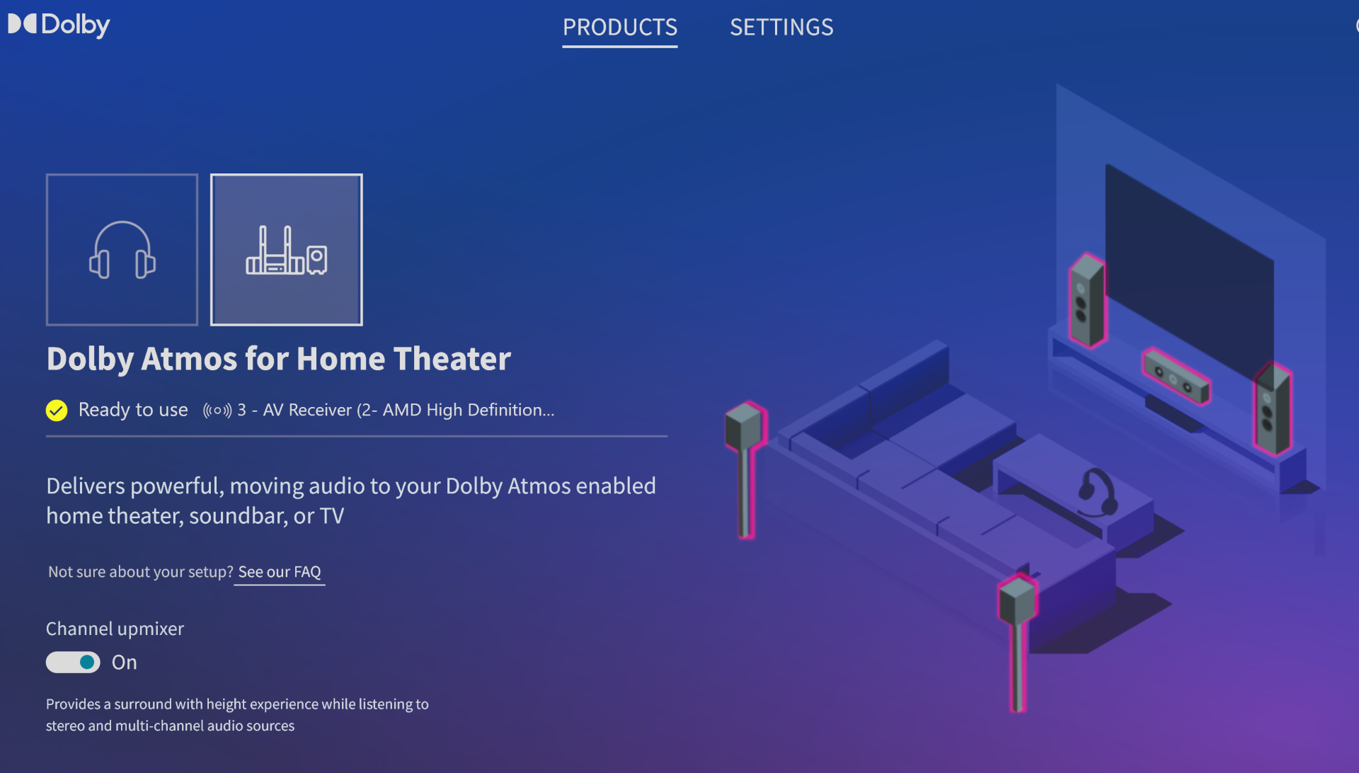

Hi, I'm testing the Q990F Soundbar and I have a few questions.
I installed the Dolby Access app (paid) and with headphones I have options in "Settings" for Game, Movie, and Music, but Home Theater says "Settings not available for Home Theater."
Is this normal? Should there be an option for Home Theater?

thats all you get for ht:
no, its manual.
