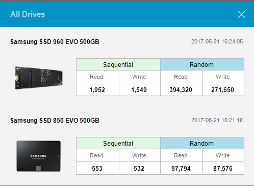

Have this mounted in a PCIe adapter, this look about right?
My 960 Evo (0.5 TB model plugged into MB M.2 slot) scores 2,748 - 1,646 - 400,352 - 269,863
Aside from your sequential reads, your drive running no faster than a SATA drive. Have you installed the Samsung NVMe driver? Might explain why most of your numbers are so low.
Yeah, those numbers are low. Here are mine:
I wonder if you have your BIOS set properly. It's supposed to be running at PCI-E x4, correct?

Keep in mind that the drive size tends to dictate small differences in performance across similar models.
That said, something is busted with OPs numbers. Those are huge differences. The adapter does introduce an extra variable in question.
OP: Does the adapter itself support NVME? (Edit: nevermind the amazon store page link indicates it does. Wonder if the PCIe device itself is using a generic driver?)

I don't think it would have *that* much of a difference.
I'd like to adjust my answer after looking more closely at that item. The adapter is a PCIe Gen 2 device, that may limit the bandwidth compared to a Gen 3 PCIe device.
Would that limit a 960 Evo? No. Might affect next year's model though.

The Magician app is not really consistent with benchmarking. CrystalDiskMark and having Window's Task Manager showing the drive statistics would be better.
Well I've tracked mine down. It's antivirus that killed my results.
CrystalMark doesn't trigger the AV, if I run Samsung Magician then it goes slow. If I pause the AV it goes much much faster.
I'm using ESET for reference.
