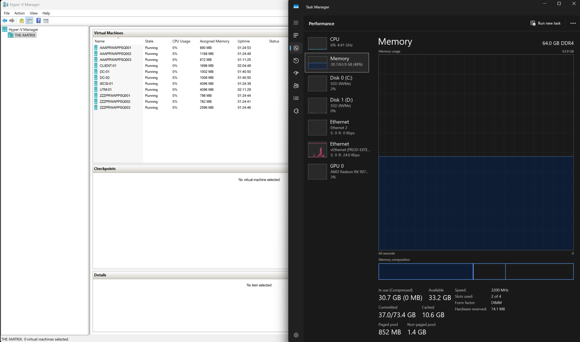

For local VM's : I love Hyper-V role versus other workstation products e.g. "VMware Workstation", "Virtual Box", etc..
Primarily the feature that works well is the Dynamic Memory feature... When testing out various Windows Server VM's... you can really squeeze a large amount of VM's on your workstation if your working through some lab scenarios, etc..
( in addition if you have worked with Windows for a while.. Hyper-V is so f'ing easy to use )

The reason I don't like Hyper-V as a workstation product is because it sticks the host OS on top of the hypervisor and ends up slowing down the host.
I like Hyper-V for pretty much everything but I'm jealous of VMWare's better vGPU/3D performance, especially for older/XP/etc systems (GPU passthrough negates this with Gen2 Hyper-V etc)
