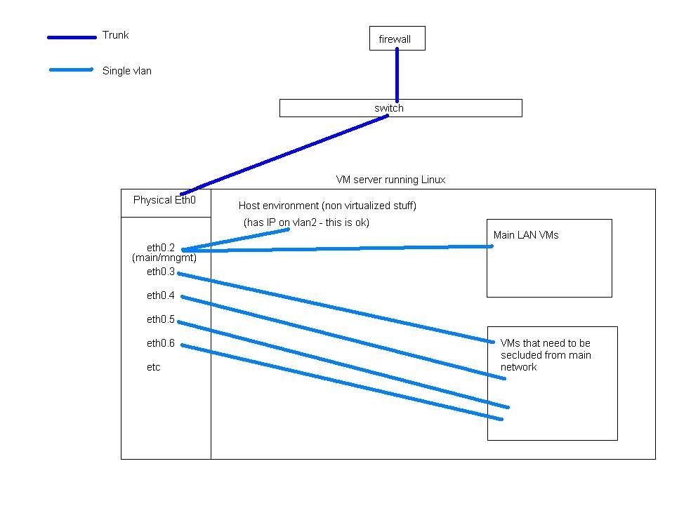

Ok, maybe you need a diagram....
Vlan 2 is the management vlan, the server has an IP on that interface, that is fine. The other vlan interfaces I do not want them to have an IP, but they HAVE to be there, the whole point is so I can bridge VMs to them and put those VMs on the various vlans. But the issue is the interfaces are getting an IPv6 IP on the host, I don't want them to be accessible at all. I only want them to work at layer 2, they are only so I can bridge VMs to them.
