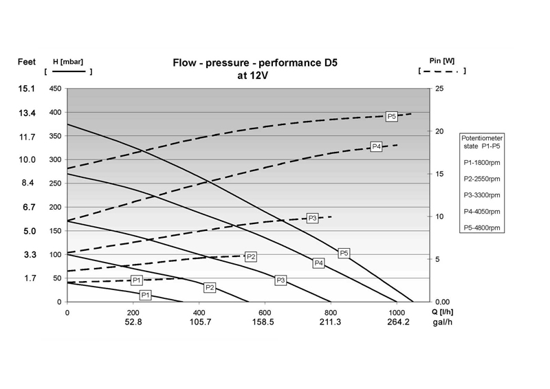

Apologies to the OP but this is a little detail thing which has been bothering me for a while... The heat dump of these is not some fixed absolute.
Here's a quick example which pertains to the D5:
Now, as you can see, that nominal power consumption rating of 24W is only attained at 0 (zero) head pressure and, thus, max flow. As the head pressure increases, the flow decreases and with that decrease in flow comes a decrease in power consumption. So, realistically, in most cooling loops, the D5 will be dumping 20W or less even at setting 5. Anything below setting 5 and the power consumption drops off real fast. The same thing applies to the 50Z, iirc, despite it being a more conventional mag-drive.
Anyway... When it all comes down to it, the flow performance of the 50Z and the D5/MCP655 gets closer and closer as the head pressure increases. The 50Z would eventually pull ahead but only when used in a very restrictive loop. So, really, unless you're stuck with a tiny radiator or are using a really low restriction loop, they're pretty much interchangeable with a slight edge going to the D5/MCP655. The difference in heat dump between the two pumps, in most situations, is likely negligible when talking about overall loop performance.
