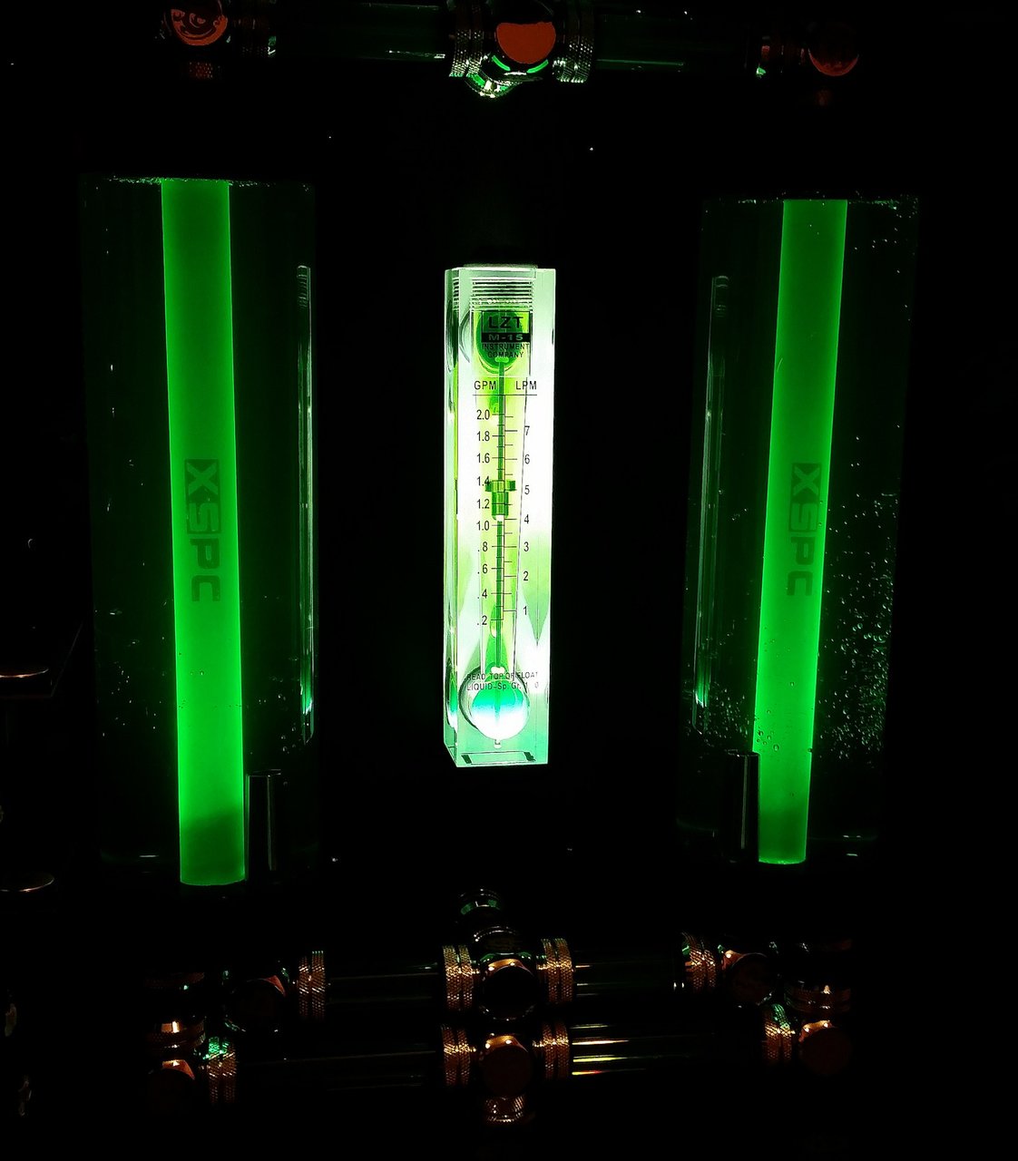

Probably going to go with something like this pic, because it reminds me of my Navy weapon system...
