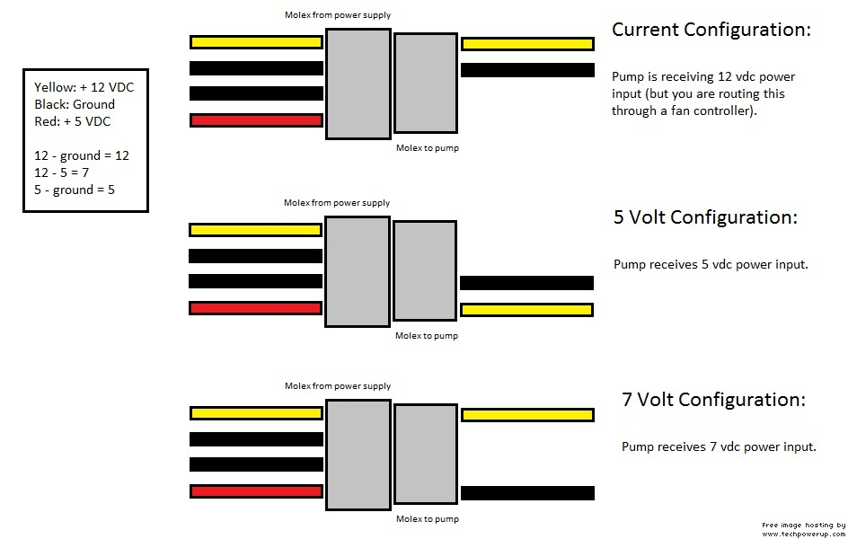

you can drop it to 7v by moving the ground pin to the outside

Thanks for the diagram Pendragon1 ! The 2 wires from the molex on my pump are RED and BLACK. Is the RED one the same as the YELLOW wire shown on the right half of your diagram?? So basically, all I need to do is swap out the wires within the molex to decrease the voltage? It's not going to short out or fry my pump right ?
no it wouldnt cause a problem BUT i just wanted to double check and apparently DDCs need min 9v. so no way to do that without a rheostat. so id drain it, make sure everything is tight and start again with less water. push it through, add more and repeat.

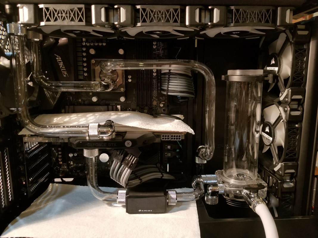

Actually, here is a picture of my completed build. I took out one of my radiator and pump/reservoir to test it out since there was a leak and that's how i was able to make the video in my original post. Anyhow, you see how i have a horizontal radiator at the top? im worried that water can't fill that radiator completely since it is at the highest point.

You know the vertical rad in my picture? Is it bad that the inlet/outlet are located at the bottom vs the top? I have heard mix opinions about vertically mounting a radiator and whether the ports should be on the top or bottom.
Wow 10mm, thats a lot! I am definitely going to tilt and rotate my case as much as possible when everything is installed.
It doesn't really matter–both have the potential to trap air at the top. Might have to add water occasionally to keep it from waterfalling.

oh i did the tilt game, thought i got it all, didnt move for 2 weeks, then one day it dropped. no leaks so it much have been a burp.
no, doesnt matter. my front rad is tubes down.
