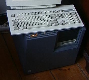

This is an oldie but a goodie...I'd try to find an Everex Step Cube to mod. This does everything you need, but you'll need to fit a new ATX PSU, and maybe a little modding for the mainboard rear panel (the Step Cube was designed in the days of the 486). Man, I had one of these, and tossed it because it wasn't working. I so with I'd kept it for modding purposes...*sigh*. I'd post pictures, but could only find one, and it was horrible (http://www.kasimir.org/misc/mvc00394_everex.jpg) doesn't even come close to doing justice. The drives were on the right in racks that would slide out from the front when you undid their thumbscrews, and the mainboard (which was 486 EISA back then and cool for its day) was on the left half. It had some decent sized fans, and a pretty cool one line dot-matrix LED display on the front.
