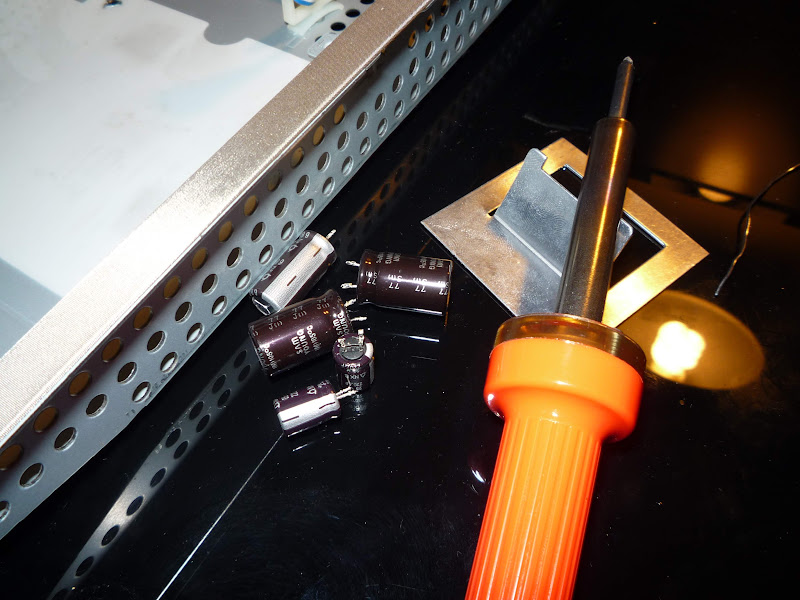

To my surprise it didn't even have bulging or blown tops on these capacitors, and they weren't even the CapXon capacitors I've heard so much about in the failure papers. They did have a brand name I've never heard of, "Sam Young" whatever those are.
I ordered some new capacitors online, Panasonic and Rubycon ones are really well made, fired up my trusty soldering iron and went to work to replace 2x 1000uF, a 680uF, and 2x 220uF capacitors on the power pcb. I put the monitor back together and BAM everything works great, its just like new :D Breathing new life back into old hardware, just the way I like it.
Here is a picture of the soldered capacitors on the rear of the power board:
Here is a picture of my finished soldering job on top with the new soldered capacitors in place
Picture of the crappy "Sam Young" Capacitors I desoldered from the power pcb
