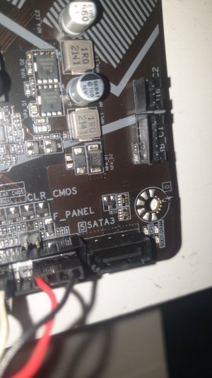

Hi,
I have purchased Z590 UD AC rev.1.1 that was already damaged. It was dropped, while still brand new and in the box, on it's corner causing the bottom right corner to bend in a banana shape around the 5th Sata3 connector. As a result of this, the motherboard wont power on, although nothing is cracked. I am not able to turn it on with the two power pins on the board "+PW-" however, if i press the "Qflash_Plus" button with the USB drive and renamed F9 bios file on it, it flashes the bios and then starts for about 5 seconds, it spins the fans on both the cpu and the gpu.
I was trying to turn on the board by other means like buying a PS/2 keyboard that has both power and sleep buttons on it but sadly this didn't work as the option "Power On By Keyboard" is disabled by default. Could I please ask for an advice on how to turn on the board with the latest F9 bios that I have at the moment that's already been reset to factory settings with the cmos jumper? I am trying to get the ACPI to command the board to turn on, sadly Wake on LAN wasn't a success either and there is no RTC set.
Ideally, if possible, a modified F9 bios that has "Power On By Keyboard" enabled by default would be perfect.
Could someone pls sent me a backup of their Z590 UD AC bios file with the "Power On By Keyboard" enabled?

That big crack by the screwhole may have broken a trace that it needs to use to boot. Almost looks like it was dropped and something heavy fell on it and bent and broke the board.
I have nothing useful to offer, but dang that bend is insane. I don't understand how that would have happened from a drop, even if it was a drop out of an airplane. Looks like someone curb stomped it.
yes and no.
No as it is ground and instead of being all around the screw hle in a shape of a letter O it is now (due to the crack) in a shape of the letter C, a test with the multimeter clearly concluded that the ground runs in a wide area around it and the crack does not affect it.
and.. Yes it might as the board has 6 layers... :(
it got whacked brand new in the box. The box is also messed up accordingly.
If all methods fail the plan is to use strong carpenter like clamps and some wood to straighten it :)

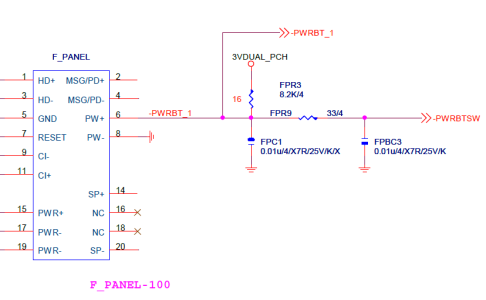

Thanks for your reply, I got it for about 40$
a) I traced it to the IT8689E chip (KBC) and gave it 3.3V (from a 2nd jumped psu) to the pin number 100 responsible for waking from S3 state (SLP_S3).
The board did start up the same way, as it did when I shorted the PSU's black to green wire (gnd to ps_on) which is: fans on, cpu led on (which indicates error), no POST.
b) checked the pins from the pwr switch = 3.37v with the psu connected, traced it to the first IC chip called ITE 5702qxn128 (which is also an RGB controller and temp monitor)
found the pins that also had the same voltage and also switch to 0.00V when pressing the power button - the board did not react.
I've tried the same method of shorting the pins with 3.37v and GND (103 and 104) on the bigger IC chip by the lan ports I mentioned earlier (the IT8689E) but the result was exactly the same - no reaction.
c) the negative pin of the header (-) is connected to ground ok, measured with the multimiter.
Attached are some resources I was following (for the IT8689E I used the schematics of IT8686E and IT8688).
