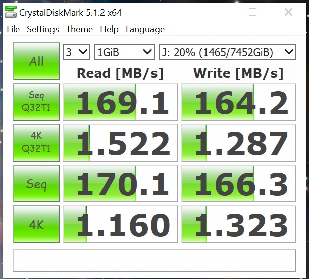

  19. Zane
    Zane n00b
    Messages:
    3
    Joined:
    Jun 15, 2016
    Bought 4 on Amazon recently and they are showing pretty decent results in CDM as all of them are WD80EZZX's
    Here are the benches for all 4 drives.
    [​IMG] [​IMG] [​IMG] [​IMG]
