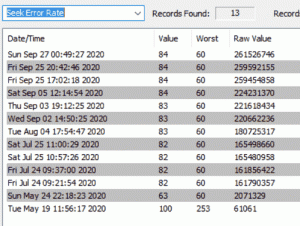

Seek error rate in detail:
smart will not always show a failing drive
the high amount of "command timeouts" most likely is a failing drive as the drive is likely trying to do a read ecc retry fail witch is hanging the drive up a lot, it hang the explorer/desktop up as well if explorer is not set to "Launch folder windows in a separate process"

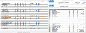

I see two transfer negotiated modes? Is this a mismatch due to a shell, or is this an external HDD top of shelf kind of purchased? It seems the data going from cable to the HDD is the issue because of that actual interface. Not that it is the cable, but the interface to the device should be symmetrical. Here is an example of an external HDD USB3.x drive I use.
Also, not all cables are proper...do a little research on it and you will find just how bad some really are. Did that cable make the interface symmetrical?
