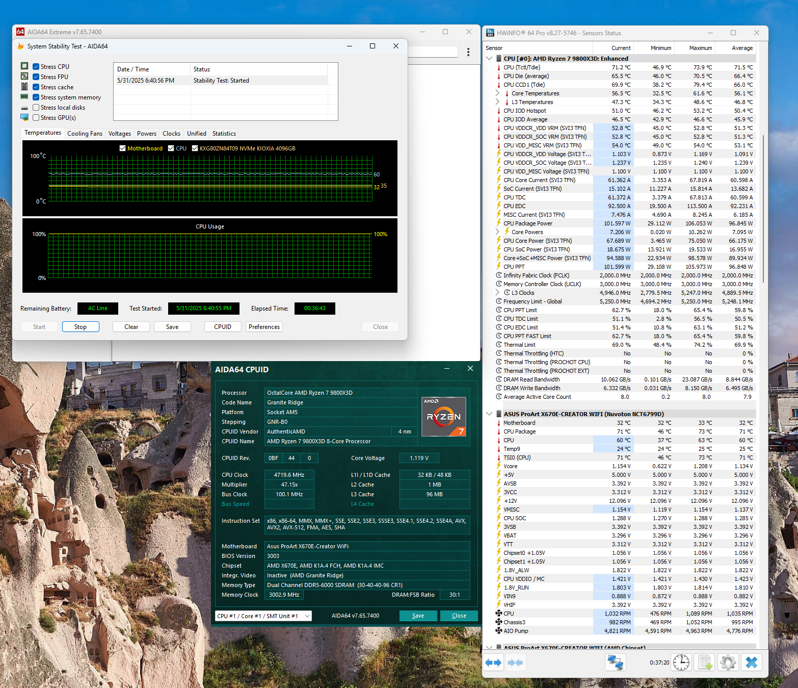

I moved from 7800X3D to 9800X3D. All I saw were bench improvements for CPU. In gaming at 4K there wasn't any difference. Both tweaked perform the same even though there is 400 MHz diff between the two (OC to OC). I think I did a whole post with results in one of the threads. Just look for a thread talking about 4K gaming and 9800X3D benches.
Here you go
I'm happy with mine, but I just disabled the high frequency CCD for now as the driver solution didn't work out well with my games. But I may try again later. I kinda liked the thought of offloading non game stuff to second CCD, but when I tried either game bar or manual affinity, it was dramatically worse than just disabling second CCD. And yea I got latest BIOS and AMD drivers.

5.5ghz locked in games, yeah. And that's stable, straight line on a graph.
Stress tests, I'm seeing 5.2ghz all core clock, again a steady line on a graph.
The numbers drop dramatically for all core load with 2nd CCD enabled obviously (power limit probably?).
What do the 9950X3D's X3D cache cores run at? I assume higher than the 9800X3D's stock 5.2GHz.
If you mess with PBO offsets and touch Scalar a little bit, you can easily see single core holding at 5.75Ghz and MT holding at 5.65Ghz, solid lines. It all depends on the load tho, P95 will drop things down to 5.2 or less depending on what part of the run. CB on the other hand, not as demanding and you will hold higher clocks.
