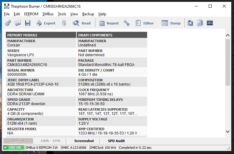

Tyhpoonburner can't determine my RAM chip
Skylinestar
Jun 14, 2011
510
Undefined and not determined. Any idea how to find the memory chip type besides totally removing the ram heat spreader?

what's the version number on the sticks. apparently 3.20 is spectek A, 3.21 is spectek B, 3.22 is some unknown micron die and 3.31 is micron B, 3.32 is possibly micron D, 4.23 is SEC D and 4.24 is SEC E. mind you the list i found is from 2016 so there may be more versions added but that's how corsair distinguishes what chips are used if a newer version of TB doesn't work.

ver 5.29
